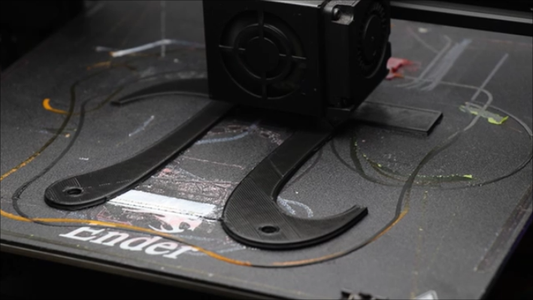

I have made this design final after doing several trial and errors, This height and width of the pi suited well for the components that i will be using in this project.
I made a note of all the dimensions of the components first before opening the design application, i will use Tinkercad for the design and it took me quite some time to finally design and export the STL file.
I later exported the stl to cura slicer, you can follow the settings that i used to print the model.
You can simply download the STL file that is given on this step below and import the same to cura software and finally slice the design to be able to 3d print later.
There is no need of any rafts or supports at the time of printing, The choice of color is left to you, i will use black pla filament to print this model.
The print time is under 1 hour and i will be printing 2 of the pi and you will see it why i did this in the next steps.

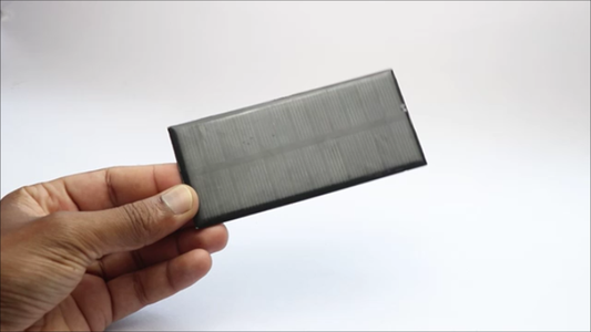

This is very important part of the pi car since we are using a single solar panel that will power this entire solar car and will take along 2 other wheels.
The circuit is really simple and straightforward.
Strip the wires of the dc motor and mark the red and black also called as positive and negative pins, Now solder the wires to solar panel if it is not done earlier.
Connect these 2 wires to the solar panel, and to make sure everything is working as expected later i recommend to test the solar panel using multimeter.
In my case i was using a 9v solar panel and i was able to get 7v when the panel was exposed to sunlight during 10am, when you test the same during 1,2 and 3pm you can expect solar panel giving out maximum output.
After we have done this step next you can connect solar panel to the pi frame, use hot glue and gently place the solar panel on top and hold it for some time until the glue is dry completely.
