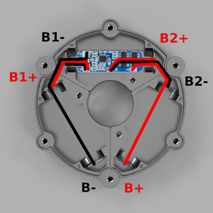

Step 4: BMS
Some BMS chips come with tabs over the terminals meant for spot welding. These do not take solder well. Desolder them before you proceed.
With the P+/- terminals to your left, and the B- terminal away from you, solder the battery clips to the BMS chip as follows.
  1. Solder the 15mm black wire to the B- terminal.
  2. Solder the 10mm red wire and 5mm black wire to the B1 terminal.
  3. Solder the 10mm black wire and 5mm red wire to the B2 terminal.
  4. Solder the 15mm red wire to the B+ terminal.
With the P+/- terminals to your left, use hot glue to secure the BMS in the battery case in the spot marked BMS. Feed the wires through the slits and openings in the case. With the BMS at 12 o'clock, fit the battery clips as follows:
  1. Install the negative battery clip connected to B- at 7 o'clock
  2. Install the positive battery clip connected to B1 at 10 o'clock
  3. Install the negative battery clip connected to B1 at 11 o'clock
  4. Install the positive battery clip connected to B2 at 1 o'clock
  5. Install the negative battery clip connected to B2 at 2 o'clock
  6. Install the positive battery clip connected to B+ at 5 o'clock
Insert a female DC connector (Adafruit 743) through the port in the case with the BMS. Solder the red wire to the P+ terminal. Solder the black wire to the P- terminal.
