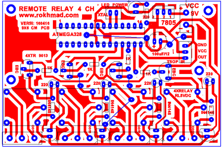

Step 3: Make PCB
Make PCB like picture above, used Transistor NPN for this project like c9013, bc547 etc , R 200 ohm, IN4001 diodes , LED 5 mm for indicator Rellay, Rellay 5 VDC,, and pick up your IC atmega 328 from your board arduino UNO R3, to this PCB.
now your project is finished
