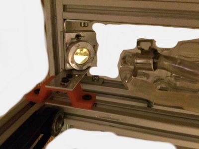

Running with a working cutting area of 90cm x 45cm x 10cm packed in a 110cm x 70cm x 30cm aluminium-frame.
The (x,y) axis is controlled via a rev. 0.4 LAOS-board, hooked up to Visicut running on Windows.
The (z)-axis is manually controlled.
Running all non-laser tube items from a slightly modified 150W ATX Power Supply Unit.
40W laser tube.
Cooled by a Laing DDC pump through a Reserator 2.

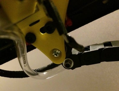

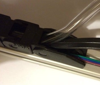

Cable drag chain length 2000mm, i've managed to run my air assist and all my wiring through these and they fit over just one extrusion. Perfect for a snug setup!

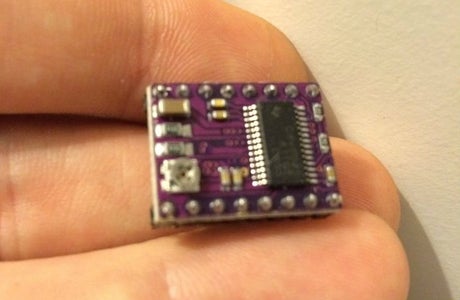

I replaced the stock 1/16 microstepping drivers with the 1/32 DRV8825, for reduced noise and greater accuracy, they are drop in replacements so everything is as normal.

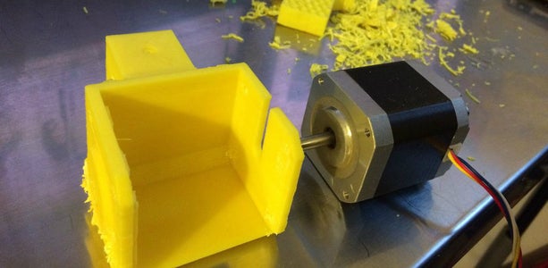

1 x Nema_17_Y-axis_motor_mount.stl

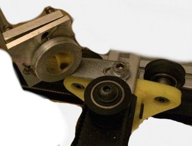

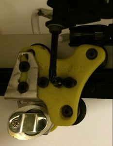

2 x Y-stage_X-stage_carrier.stl
1 x X-stage_mirror+focus_carrier.stl
1 x X-axis_steppermount.stl, will need support in most printers as far as i remember.

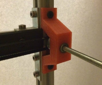

Z-table framemount.stl
3 x M5x12
3 x M5 T-nut
1 x MR126 ZZ, pressfit
1 x M3x8
1 x M3 nut, pressfit
