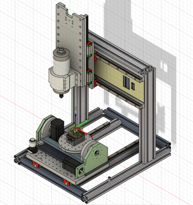

Step 1: The Design Behind the Mill
First Step in the process of the manufacturing of the Mill was the design Phase. Since this is my graduation project to finish high school, this was split between me and a classmate of mine. Our goal was to fit the Mill on most desktops and in even the smallest of Workshops. The other goals were:
1) it runs on 230V/13A wich is the standart european circuts, and i dont have more than this in my workshop.
2) easy manufacturing to save costs in the building Process and enable it to be built by people without a well equipt shop
3) a Construction with a highly rigid frame to cut aluminium, brass and titanium effeciently and enable small scale production runs
4) a maximum Budget of 5000€ which is still chaeper than some dektop 3axis cnc`s
5) all electronics are housed within the Mills enclosure to prevent damage to the wireing and electronics when moving the cnc

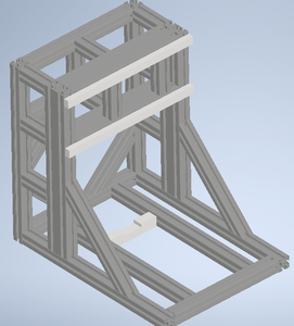

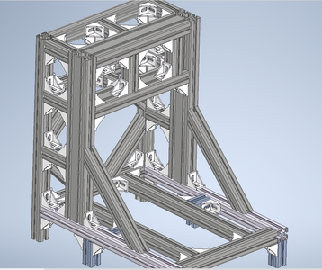

Step 3: The Frame
The next Step was acsually starting to build the CNC. We startet with the Frame out of standart 4040 and 4080 Aluminium extrusions, held together with a rediciolus amount of 90° angles and "blind joints " with t-nuts,
the Frame is made of Extrusions because a) they are verry easy to get, and b) they are even easier to work with and can be adjusted slightly for perfect 90° angles between the differnt axies of the mill
it might be overkill to add this many braces in the frame, but better save than sorry, and a rigid frame is the base for a good CNC mill. By the way, try to overbuild the frame, its the hardest part to upgreade once you have a mill, on the other hand a spindel can be changed in less than 2 hours. A frame will take for sure longer than that.

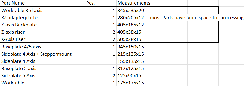

Step 4: Manufacturing the Custom Parts
We generally tried to use as many Off-the-shelf parts as possible, but we still hat to custom make some ourselfs. Most parts were Quite simple, bought the Stock for the parts already cut to size, and printed a lage drawing of the parts, glued it on and used it to drill all the holes, but some are NOT YET modeled in CAD as i changed some things to properly work as intended.
For the more complicated parts we needed a more precise way to make them. In School we attend, You also learn the basics of machining. If you ask me thats the coolest part. So after 3 months of internships (and some convincing of my parents) i finally bought myself a small CNC Mill. Aside frome other Projects this also came in clutch on this one, most components were milled at home in my basement

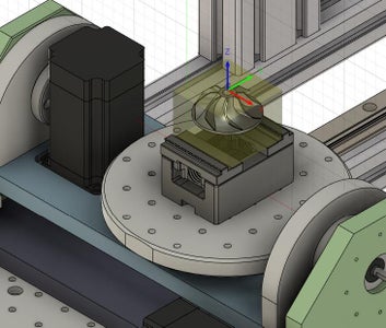

And here is where fusion comes into play. All the CAM was done on a fusion 360 student licence, in the picture you can see the CAM for the adapter-plate between X and Z axis. its all quite basic adaptive, contour and bore milling, but verry intuitive and ensures the absolute Precision thats needed to ensure a smooth operation and (not less important) assembly

Step 6: Machine Simulation in Fusion 360
Probably the best Feature in Fusion 360 is the verry accurate simulation of Toolpaths. You can detect chrashes before the happen in real life and get a better feeling for how the machine will move. This is probably the reason why you see guys like John from NYC CNC and John from Grimsmo Kinves using this feature in almost every Video. And if its good enough to make parts to the incredibly tight tolerances and keep production machines from chrashing that cost 6-7 digit amounts of Dollars it is for sure good enough for me :)
Also once you have a accurate model of your machine it only takes about half an hour to set it up, so its really a thing i`d reccomend to all fusion users. I highly reccomend the Youtube videos fusion published, without them i would have taken to figure out all the options that must be ticked. The only thing i changed is, i removed all parts that are not needed to visualise the machining of parts like the Enclosure and so on, since my computer is not taht powerful and performes way better this way
I've linked a small example of a Toolpath i simulated
