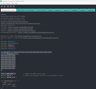

Step 16: Modify the Firmware
Open the firmware from the ".../V1.1/Firmware_for_receiver" folder, and then open one of the following firmware based on your language preference:
- For English: Navigate to ".../V1.1/Firmware_for_transmitter"
- For Hebrew: Navigate to ".../V1.1/Firmware_for_transmitter_Hebrew"

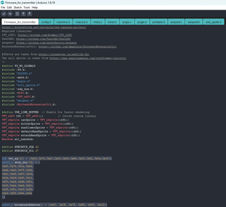

- Replace the cryptographic keys, as well as the receiver's MAC address in the "uint8_t broadcastAddress[] = {0x5C, 0xCF, 0x7F, 0xFD, 0x85, 0x1D}; // Receiver's MAC address" line in the transmitter's firmware. You can also change the background color by modifying the value defined in the "COMMON_FILL_COLOR" (as well as the other parameters).
- Replace the cryptographic keys, as well as the number of LEDs in the strip in the " #define LED_COUNT 32 // Number of LEDs in the strip" line in the receiver's firmware.
Step 17: Flash ESP8266
Upload the modified firmware from the ".../V1.1/Firmware_for_receiver" folder into the ESP8266.
Step 18: Flash ESP32
Upload the modified transmitter's firmware into the ESP32.
