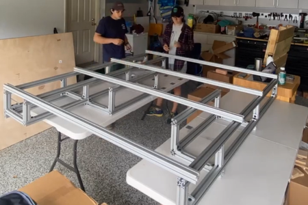

Step 1: Building the Bed Frame
Ashleigh & Zach drew inspiration from another Van Life Instagram account @engineerswhovanlife who used 80/20 extruded aluminum to build their bed frame. After studying their design, Ashleigh & Zach added additional extruded aluminum to support the linear actuators that adjust their bed.
The bed frame was first put together outside of the van before more adjustments were made to accommodate linear actuators. Their bed frame consisted of 80/20 aluminum beams spanning the entire width of the van, securing to both walls, and providing the surface the bed platform would rest on. It also included a lower level where electric linear actuators could be mounted.

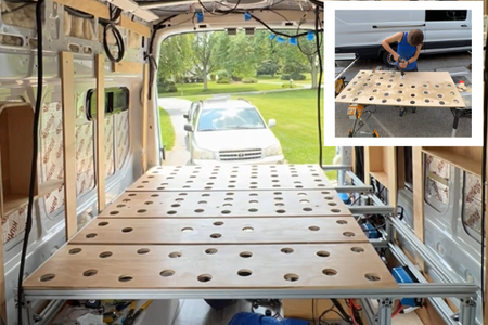

Step 2: Constructing the Bed Platform
The next step was figuring out how to build a bed platform that would fold in the proper locations. After taking measurements of the underside of their old bed frame, Ashleigh & Zach designed their very own adjustable bed platform from scratch. Their wooden bed platform consisted of 4 separate pieces of 1/2" birch plywood.
The 1st piece moves to adjust the head, the 2nd piece mounts to the frame to serve as the anchor, and the bottom two move to adjust the height at their knees. Using hinges, the four pieces were connected to ensure a full range of motion with what the actuators could provide. After cutting the plywood to size, a hole saw was used to cut ventilation holes. The entire wooden platform later got coated with polyurethane for added protection.

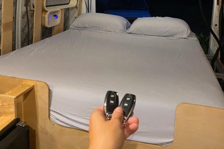

Step 3: Choosing an Actuator
When multiple actuators are required to travel synchronously, we recommend actuators with hall effect sensors. This is because they have hall effect feedback that goes to a control box which would then be able to make the needed corrections if one side travels at a different speed from the other. Differing speeds can sometimes happen from slightly unequal weight distribution or the speed tolerance from the DC motors (+/- 10%) in the actuators.
After calling customer support, our team was able to assist Ashleigh & Zach in choosing 4x PA-04-10-400-HS Hall Effect Sensor Actuators and 2x PA-40 Control Boxes. Being 12 VDC operated ensured future compatibility with their van’s 12 VDC power source while the 400 lbs force rating of each actuator offered them plenty of lifting capacity. They enjoyed the power and reliability of our linear actuators as it brought them confidence in making their dream become a reality. With the push of a button, the PA-40 wireless remotes would allow them to raise the head, the foot, or both sections of their adjustable bed.

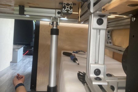

Step 4: Mounting the Actuators
At the head section of the bed, the rear mounting holes for PA-04 HS actuators were mounted to the lower level of the frame using roll-in T-nuts and bolts while the front mounting holes were connected to the platform. L-shaped 80/20 supports were made and connected to the bed platform using our BRK-02mounting brackets. Then, the actuators were mounted to that L-support by using T-nuts.
For the foot section of the bed, mounting was done vertically instead of at an angle due to space constraints. At their max extension, the actuators would have exceeded the hinges' range of motion if the original design was used, so they had to pivot! To do this, they attached the actuators vertically to the underside of the bed and let them hang. They then measured the distance between the bottom of the actuators and the floor and constructed wooden boxes with 1/2" birch plywood to mount the feet actuators to.
