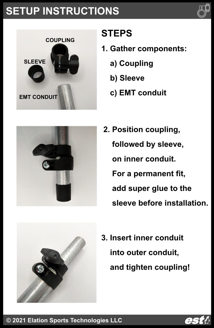

Step 3: Assemble the Telescoping Pole
These EMT conduit telescoping clamps make it easy to create a telescoping pole out of EMT conduit! They're made of injection-molded UV-resistant and durable plastic which is suitable for outdoor use, and they clamp onto the outside of the conduit - no drilling required!
Add one 20mm black rubber pole cap to the tip of the 1/2" EMT conduit end of the pole. If you choose to use 3/4" EMT conduit as their top section of the pole instead of 1/2" EMT conduit, use a 25mm black rubber cap instead of a 20mm one.
Insert the ground stake into the earth, and then install the bottom 1" EMT conduit end of the pole into the ground stake. Depending on the EMT conduit vendor, the fit may be a little tight, but this helps to keep the pole sturdy.
