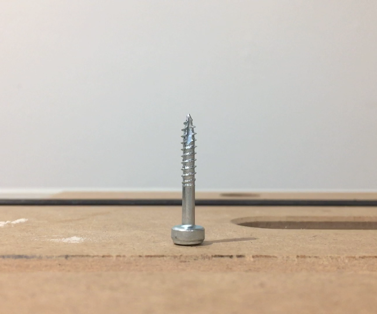

Step 1: How It Works
T-tracks on the edges of each profile provide the size adjustment, and pocket holes (with machine screws) lock in any specific size.
The hardware used is:
- #10-32 x 3/4" machine screws
- #10-32 hex nuts

Step 8: Drill Pocket Holes
It may take some trial and error to get the position of the pocket holes just right so it fits in the T-tracks. Just be patient.
