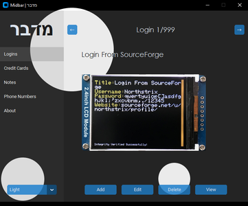

After making the Midbar Firebase Edition V2.0, I realized that even though it's a fully functional vault synced with the desktop app, it's still insufficient. For starters, it only allows the user to store login credentials on it, not to mention that the desktop app provided with that version was raw and a bit slow as it had to load the whole record from the Google Firebase and not just its title, in other words, there was no preview function. In addition to that, the hardware vault utilized a small 160x128 screen and couldn't emulate the USB keyboard. To negate these flaws, I took Midbar V6.0 as the base, replaced the encryption algorithm, and modified it to utilize the Google Firebase as the filesystem. I also made a new desktop app that enables users to work not just with login credentials but also with credit card details, notes, and phone numbers. The desktop app provided in that version only loads the whole record when it's being viewed or edited, allowing faster movement between the slots in the main menu.
This version of Midbar stores the encrypted data in the cloud while keeping the cryptographic keys on the edge!

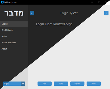

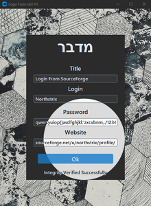

*By the way, some pictures demonstrated in this tutorial are taken from the tutorial for Midbar V6.0 because, aside from a few minor modifications, the GUIs utilized by both Midbars are basically the same.

The integrity verification feature of Midbar is based on "HMAC-SHA256." When you enter data into Midbar, it consolidates all the data into a single string, computes a tag for that string, and saves the newly computed tag in encrypted form. When you decrypt your data, Midbar also decrypts the previously saved tag and computes a new one for the decrypted data. It then compares both tags. If they don't match - Midbar notifies you that the integrity verification failed.

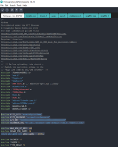

Step 9: Modify the Firmware
Open the "Firmware_for_ESP32.ino" file from the "...\V3.0\Firmware_for_ESP32" folder and modify the values of these four variables:
WIFI_SSID
WIFI_PASSWORD
API_KEY
DATABASE_URL
Also, adjust the values in these two lines if needed:
#define MAX_NUM_OF_RECS 999
const unsigned int iterations = 20451;

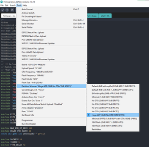

Step 10: Switch the Partition Scheme to the "Huge APP (3MB No OTA/1MB SPIFFS)"
You have to switch the partition scheme to the "Huge APP (3MB No OTA/1MB SPIFFS)" before you continue working with ESP32 because the firmware is too big for the default partition.

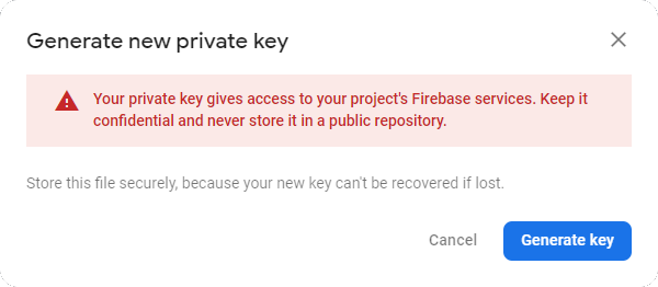

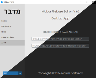

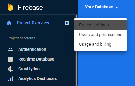

Step 14: Get the Firebase Private Key
To enable the desktop app to interact with the Firebase, you need to get the private key and place it in the same folder as the desktop (client) application.
To do so:
  • Open your database;
  • Click on the “Settings” icon;
  • Click on the “Project settings” line;
  • When the next tab loads, go to the “Service accounts” tab;
  • Click the “Generate new private key” button;
  • Click the “Generate key” button in the pop-up window;
  • Save the private key to the “…\V3.0\Desktop App” folder under the “firebase key.json” name.

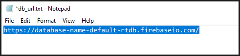

Step 15: Add Database URL to the Desktop App
Navigate to the “…\V3.0\Desktop App” folder, open the “db_url.txt” file, replace my database URL with yours, press “Ctrl + S” and close the file.

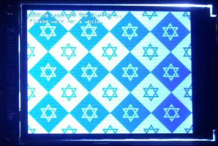

Step 16: Power the MCU Vault Up
That version of Midbar offers you 14 lock screens. It randomly chooses a lock screen when it initializes the connection to the Google Firebase and then chooses another one when it asks you to press any key to continue.

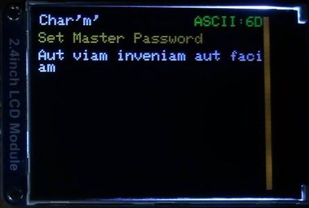

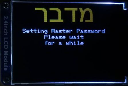

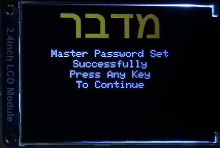

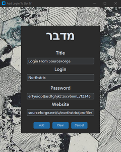

Step 17: Set Master Password
Once you configure the MCU password vault and the desktop app, set the master password. The master password can be set using the MCU password vault or the desktop app, whichever you choose.
