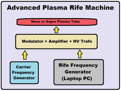

 In general, the device consists of several components:
 - A carrier frequency generator, which can generate a signal in the range of up to 100 MHz with great precision and tuning steps, and the frequency is displayed on a color TFT Display. Detailed instructions, scheme and code for this generator can be found in one of my previous videos (https://youtu.be/KSovEpCmWY0)
Step 3: Frex16
 - A Rife frequencyes generator, which in this case is specialized PC software for this purpose, installed on a laptop computer with a sound card.
 - A modulator that modulates the RF carrier frequency with low-frequency Rife signals.
 - An amplifier of this modulated signal which, together with the high-voltage transformer, drives the plasma tube.
 - A plasma tube to output the power in the form of radio waves to penetrate the body and deliver the frequencies.
