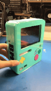

For my BMO shell, I decided that since there is a maker space near me, I’m going to create it out of acrylic using a laser cutter.
I designed my BMO using Adobe Illustrator by first measuring the length and width of my display and then creating a curved rectangle around it to look like BMO. To make sure that you won’t need to go back and redesign the whole thing again, plan carefully and take measurements of everything, like where you are going to place the raspberry pi and batteries, the dimensions of the buttons, how thick or thin you want BMO to be, the placement of the buttons, and so on
From there, I added shapes for the D-Pad, buttons (with additional X, L, and R buttons so I have full functionality of SNES games), and all the other features and sides, and went to laser cut it (Fig.7).
After that It was time to build using glue, tape, and any other methods to keep it sturdy. From my experience, I learned that using acrylic, hot glue doest stick well and you would either use tape or super glue, or create holes to use metal bolts and locks to attach the parts of the shell together (Fig.8).

Now that your shell prototype is relatively ready, try putting your components in to test if all fits well or not (Fig.9). You may need to create another prototype shell as I did too as seen here (Fig.10), but that’s alright! Revision is part of the design thinking process! Measure what does not fit and update your design with your new measurements (Fig.11). If planned carefully, your first try would be usable with minor tweaks!

We are nearing the final stages of this build. Now that everything is working, we need to put the parts all together into the case (Fig.20). Sometimes, with the added wires, the components may not fit as snug if it's all jumbled up, so make sure to keep those wires tidy and neat as you can (Fig.21). If you can close everything into the shell, test it out and make sure all the components are working well (Fig.22). If so, you are ready for the final step.
