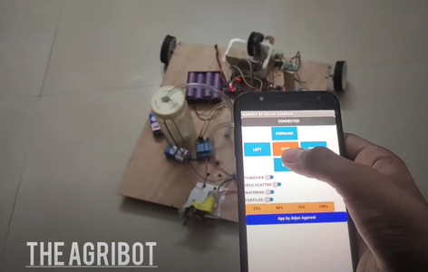

I am Arjun Agarwal, I'm in class 8, a 13 year old made a Robot which could help in agriculture. I coded it myself and made the app also myself. It can plough, dig, plant, water and fertilize the land. I could also be controlled by a phone using Bluetooth. I made the application myself and to prove my point, I even inserted my own watermark- "App made by Arjun Agarwal". To download the app- Click here.
To view click on the link->

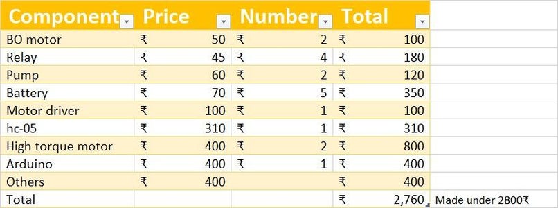

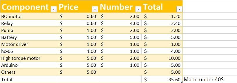

- BO GEARED MOTORS
- RELAY MODULE
- PUMP
- 18650 cells
- 9v battery
- L298N MOTOR DRIVER
- HC-05 BT MODULE
- JOHNSON MOTOR
- ARDUINO UNO
- OTHERS(WOOD, TOOLS, CLAMPS, SCREWS)
Step 1: Making the Frame
Make the Chassis using MDF wood and make holes for motor clamps and the spray tube of the pump outlet. Now attach the 2 pumps and then attach their outlets to the hole in the mdf. Attach the driving high torque motors.

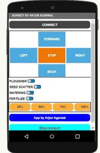

Step 6: Download the AgriBot App
Now you can download the agribot app made by me-
Just click here to download the apk. This is not there in the play store due to the fees we need to pay to get it in playstore.
