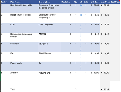

Step 3: Material List

3 sensors are included:
- Microphone
- Barometer
- Temperature sensor
