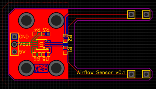

Step 1: Electrical Design
As discussed in the theoretical thoughts a wheatstone brigde is used to measure the signal. An INA333 instrumentational amplifier with a gain of 5 and a voltage reference of 2.5 V is used to get a suitable ananlog signal which can be measured with an arduino or other microcontroller.
Step 2: Layout
The layout of the PCB is pretty simple. The two NTC Resistor can be solderd in the front, with small wires so as low as possible amount of heat is wasted.
The PCB can be manufactured through the usual channels. On the back of the PCB is a 8x8 mm rectangle for a QR code or data matrix
I can provide the Gerber files on request.

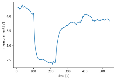

Step 4: Testing
A voltage on the Analog pin of around 4 is reached through the self heating of the NTC resistors. When they are cooled the voltage drops to 2.5 V which is the reference voltage set on the operational amplifier. This reference voltage could be lowered to give a higher measureing range with a higher gain set on the operating amplifier. Good results that don’t have too much noise is achieved with a condesator close to the module and a pulldown resistor on the analog line.
