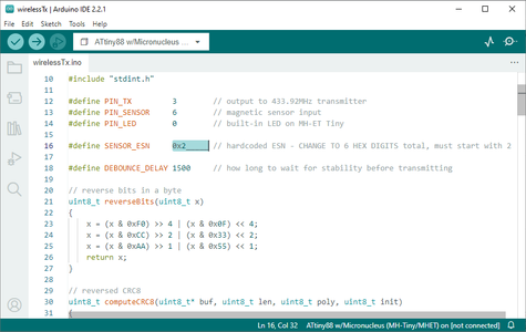

The crucial step before compiling is to change the ESN in the code (serial number of the sensor, see the attached screenshot), compile it, and upload it to the MH-ET Tiny board. Make sure the ESN is unique in your installation (and in the area)! The ESN needs to start by the digit 2, as it identifies the type of sensor. If you use something else, it will most likely not work!
If you need to, you can also change pin numbers, although you need to be careful as some pins have reserved functions.
I cannot provide pre-compiled code since the ESN is hardcoded. Additionally, the simplest way to program the board is through the Arduino IDE anyways, so installing and configuring the Arduino IDE for this board is already the simplest path.

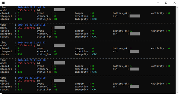

- Use rtl_433 with the DSC decoder (see the attached screenshot). You can let it run on a Raspberry Pi, and process the received signals as you see fit.
