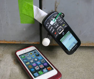

And your tripwire is complete!
How to set up and activate your tripwire :
The clothespin holds the number 8 key down on the phone, and so you need to separate the two halves with a thin piece of paper. Receipts work great for this.
When the paper is removed, the contacts on the clothespin touch and the phone will speed dial your number.
You’re probably going to need to exit out of the door that you’re booby trapping—I mean trip wiring—and so you’ll need to set it up like this:
Tape your trip wire device to the wall and drape the string over the doorknob.
Run the string under the door and make sure to give yourself enough slack to get outside.
Once you’re outside, it will look like this.
Slowly close the door while pulling the string under the door toward you. Don’t pull it tight, but remove all the slack until you feel it tugging against the doorknob on the other side.
Just before you shut the door, tape the string to the threshold.
Now cut it and shut the door.
