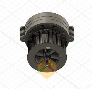

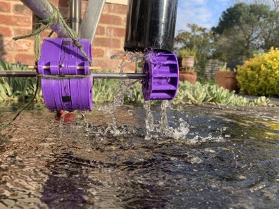

This is an open-source 3d printable alternator designed to harvest energy from drainpipes however making the alternator is a great way to learn about alternator design, 3d printing and faradays law.

Step 1: Printing the Parts
Print all the files from our GitHub page. We recommend 3 layers and 30% infill.

Step 5: Assemble the Alternator
Steel rod goes through the middle. On the rotors, you can use screws to attach them.
Step 6: Enjoy Your Alternator!
