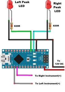

Step 3: Peak Meter Part
 I also added a peak meter circuit, whose function is each time when the signal exceeds the specified level, turns on RED led. It was easiest for me to use an microcontroller for this purpose, because I can very simply and precisely set the activation threshold of the LED in the code. This is an Arduino Nano clone that costs less than $2 and doesn't add much to the cost of the device. Of course, if you have no experience with microcontrollers, you can make a very simple peak meter with transistors.
 If we use the VU meter as an independent device as in my case, there is no need for calibration and the sensitivity can be adjusted with the potentiometer. Another option is to embed it in some audio device, for example between the preamplifier and the output amplifier, in which case we need to calibrate using a reference calibrated VU meter.
