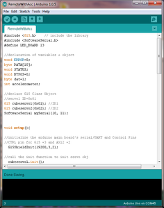

6. Program the Arduino UNO ( download the source code below, compile and download the Arduino UNO).
