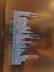

Step 2: Setting Up the Software
The first thing we did was install the Emulator on the Raspberri pi, followed by the software Retropie. After that we formatted a usb drive and putting umulator games on it.
We followed a step by step guide, linked here.
