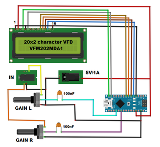

The presented device is very simple to build, and consists of several components:
- Arduino nano microcontroller
- VFM202MDA1-1 type VFD Display wich is slightly modified
- Stereo potentiometer to control the intensity of the input signal
- and two capacitors

In the pictures you can see how the device is made
Step 3: Schematic Diagram and Code
For analysis and processing of the audio signal is used "fix_fft" library. As for the code, the base is taken from Ray Burnette with some minor tweaks. New code is adapted for 20x2 characters, increased noise sensitivity threshold and some minor visual corrections. The device is built into a suitable box made of PVC material with thicknesses of 3 and 5 mm, coated with self-adhesive wallpaper. A thin transparent filter foil is placed on the front of the display.
