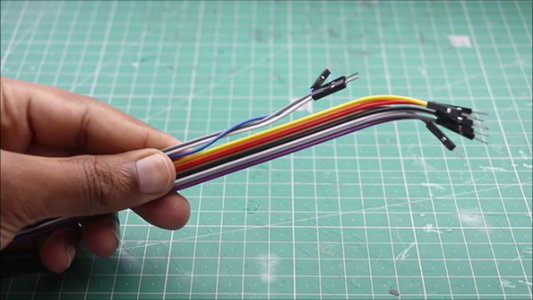

Step 1: Circuit Diargram
The circuit used in this project follows simple logic.
The PS2 module or analog joystick module as few call is kind of potentiometer, When the button is moved each time the change in resistance occurs and this is used to control the servo movements
The micro servo has 3 pins, The positive and negative supply and the signal pin
Connect the + and - pins to the 5v and Gnd pins of the uno board, Whereas the signal pin is connected to D3 pin of uno.
Joystick module has 5 pins and in this project we are using 4 pins
The 5v and gnd pins are again connected to the 5v and gnd pins of the uno board
Vrx and Vry pins of the joystick module are connected with the analog pins A0 and A1 pin of board.

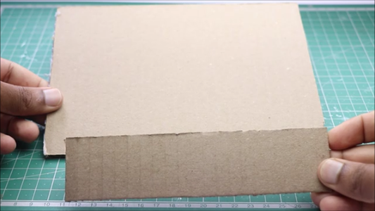

Step 4: Joystick Holder
Are you wondering why i place this ps2 module at the bottom even though i had lots of space on the top part.
The answer is simple, if i had placed there at the top it would cause distraction when the balance stick is moving sideways.
To make the wire less visible follow the steps like i did, i have made a small hole in the body and inserted wire through it, Use a small piece of cardboard to place the joystick and secure it with hot glue.
Check for the wires connection again before you place all the components inside this box.

Step 5: Balance Stick
I call this a balance stick as we are placing the ball inside this and balancing them.
I thought of using the cardboard here but those come with slight friction, I got rid of this issue by simply using a plastic ruler.
Use a 15cm ruler and to the sides of this add small strips of cardboard, This cardboard will act as a barrier to hold the ball within.
Leave the sides as it is since this is the place where the balls will be falling off.
The horns of the servo was not long enough to hold this, so I extended the servo length by adding a small piece of cardboard.
I had marked the center earlier and now all i did was glue the ruler to this cardboard and hold it till it dried completely.
