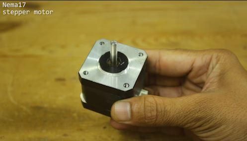

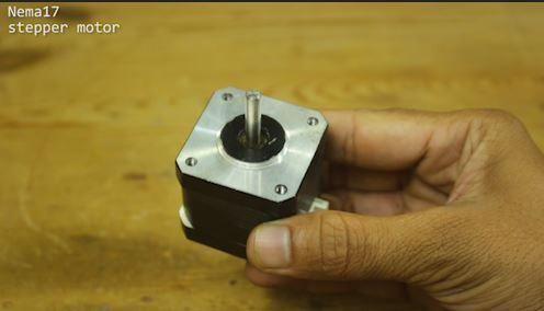

Nema 17 Stepper Motor:
  • The Nema 17 stepper motor is a powerful, precise motor used for controlled motion in your project. It's often used in applications requiring accurate positioning, like 3D printers and CNC machines.

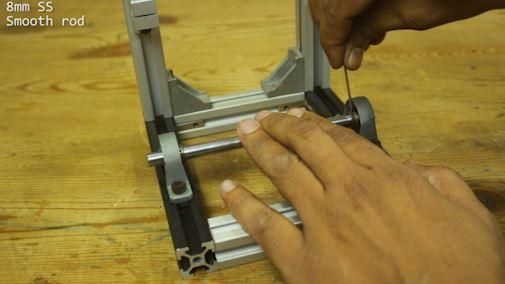

8mm Smooth SS Rod:
  • The 8mm smooth stainless steel rod serves a similar purpose as the 5mm version but with a larger diameter, providing increased load-bearing capacity and stability.

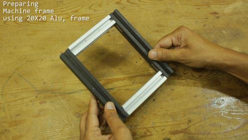

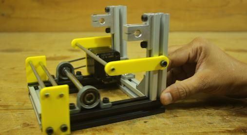

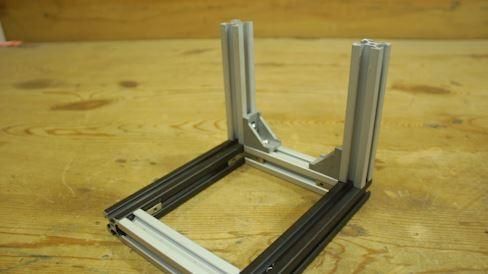

Step 1: Making Machine Frame Using 20x20 Profile
Creating a Label Sticker Dispenser Machine Frame:
Making the frame for a label sticker dispenser machine is like building the skeleton of a robot. This frame will hold everything together and make sure the machine works smoothly. We'll use some materials like a 20x20 aluminum frame, a Nema 17 stepper motor, an 8mm smooth rod, 8mm pillow bearings, and some 3D printed parts.
Step 1: Get Your Materials Ready
Gather all the materials you need. These include the aluminum frame, the Nema 17 stepper motor, the 8mm smooth rod, 8mm pillow bearings, and 3D printed parts. Make sure everything is clean and in good condition.
Step 2: Assemble the Base
Lay out the 20x20 aluminum frame pieces on a flat surface to create the base of the machine. Make sure they fit together properly. You might need to use screws or brackets to secure them in place. This base will provide stability for your machine.
Step 3: Attach the Stepper Motor
Now, fix the Nema 17 stepper motor to the frame. It's like attaching the heart of the machine. This motor will help the machine move the stickers.
Step 4: Install the Smooth Rods
Slide the 8mm smooth rod into the pillow bearings. These bearings will make sure the rods can turn smoothly. Attach these rod and bearing assemblies to the frame. Think of them as the machine's arms that will carry the stickers.
Step 5: Add 3D Printed Parts
You might have some 3D printed parts that are custom-made for your machine. Attach these parts to the frame as needed. They can be like the hands and fingers of the machine, helping with the sticker dispensing process.

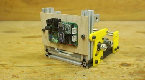

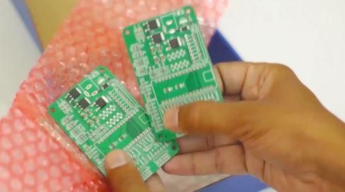

Step 2: Electrical Wiring and Custom PCB

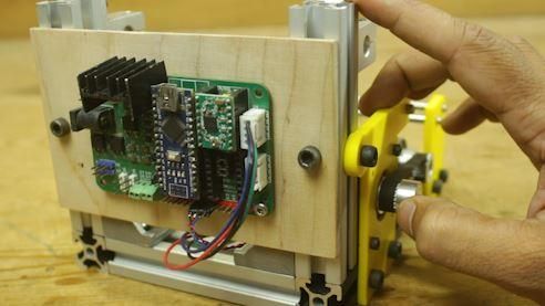

Wiring Connection Details for Arduino-based Label Sticker Dispenser Machine:
In the assembly of your label sticker dispenser machine, it's important to have clear and accurate wiring connections to ensure proper functionality. Here's a detailed write-up on how the wiring is set up for your project:

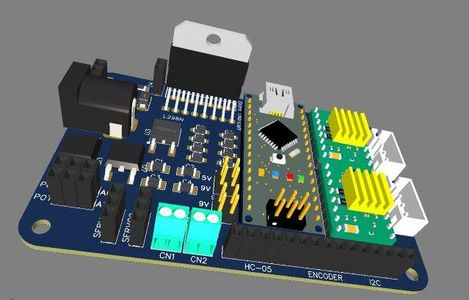

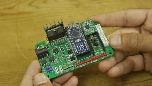

  1. Arduino Placement:
  2. The Arduino Nano is securely placed on a multipurpose PCB (Printed Circuit Board). This PCB acts as a central hub for connecting various components, allowing for organized and efficient wiring.
  3. Stepper Motor Control:
  4. The Nema 17 stepper motor is controlled by an A4988 stepper motor driver. The A4988 driver is set to operate the stepper motor in 16th steps mode, which provides precise and smooth motion control.
  5. Wiring the A4988 Driver to the Arduino:
  • The step pin (for controlling the step movement) of the A4988 driver is connected to the A1 pin on the Arduino. This connection ensures that the Arduino can send step commands to the stepper motor through the driver.
  • The direction pin (for controlling the rotation direction) of the A4988 driver is connected to the A0 pin on the Arduino. This connection allows the Arduino to determine the direction in which the stepper motor should rotate.
  1. Power Supply for Stepper Motor:
  2. The stepper motor is powered by a 12V DC power supply. This voltage level is suitable for the Nema 17 stepper motor's operation, providing the necessary power for its movements.
  3. IR Sensor Connection:
  4. An IR (Infrared) sensor is used in your project, and its output pin is connected to digital pin 4 on the Arduino. This connection enables the Arduino to receive signals from the IR sensor, which may be used for detecting objects or providing input based on proximity or presence.
By following these wiring connections, you ensure that your label sticker dispenser machine is set up to control the stepper motor accurately, receive input from the IR sensor, and run on the appropriate power supply. This organized and well-connected system is crucial for the successful operation of your project.
Step 3: CUSTOM PCB

Our multipurpose PCB is a game-changer, designed to serve a multitude of projects. With JLCPCB's top-quality boards, you can now rely on a single PCB for a wide range of applications. Say goodbye to the hassle of designing new PCBs for every project.
