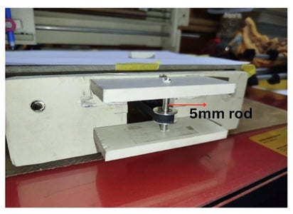

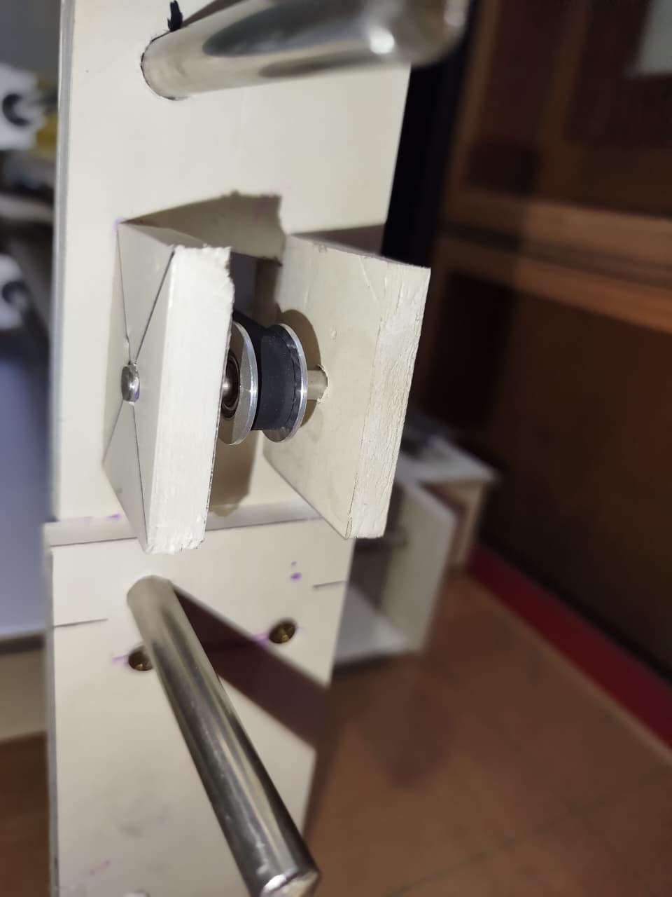

Step 2: Making Y Axis
First, we will make the Y and X axis. Then we will move to the software part.
I am using 8mm pvc board for this and to join them I used chloroform (see image reference). You can use super glue but super glue is fast drying and creates more permanent bond than chloroform.
It dosen't matter how you make your axis, make to it is sturdy and have a smooth motion without any wiggle.
small tip: select linear rod and bearing carefully. Purchase Grade A rod and sealed high quality bearing only.

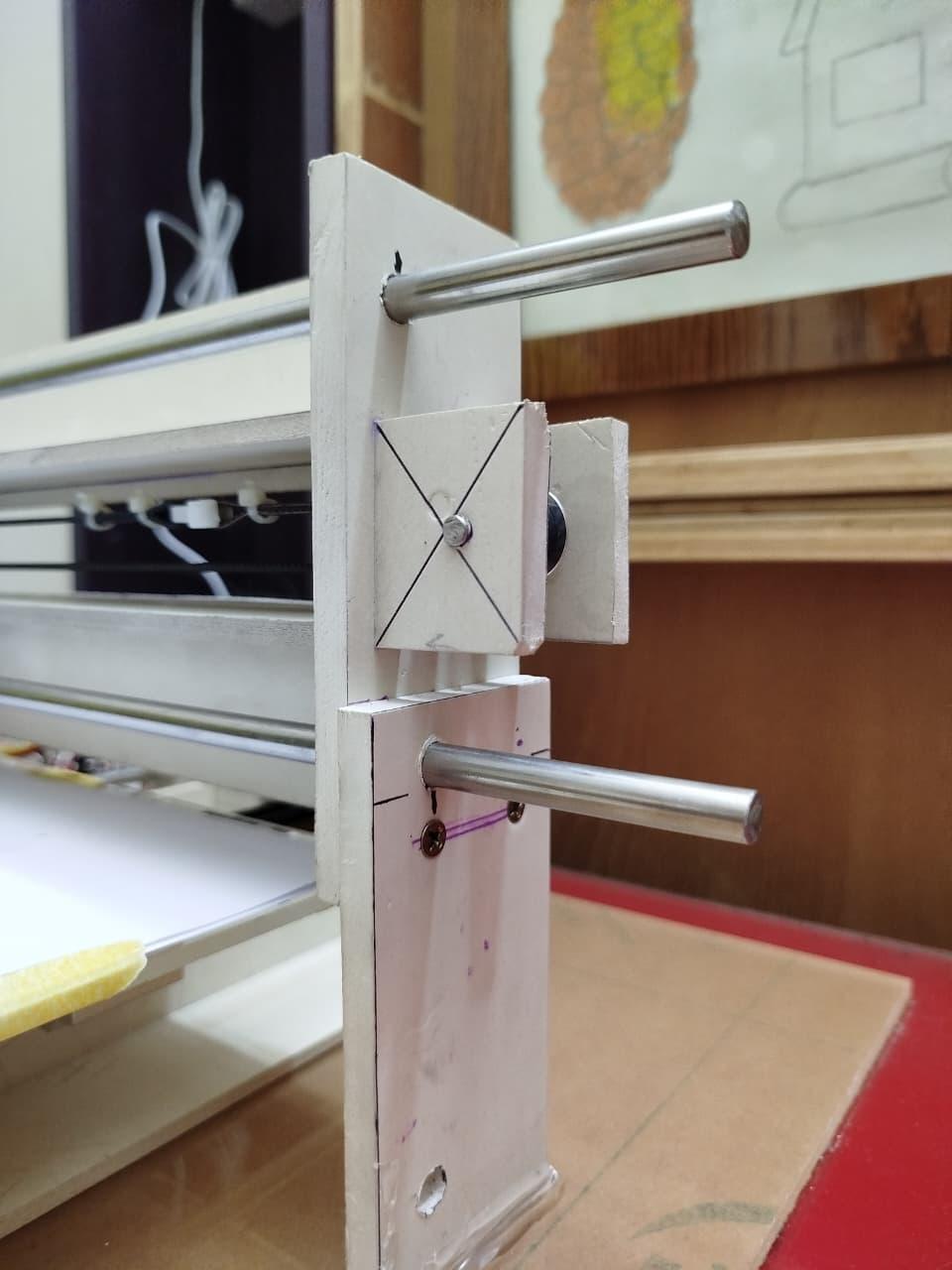

Step 3: Making X Axis
Same process goes for the x Axis. To attach the bearing I used super glue.

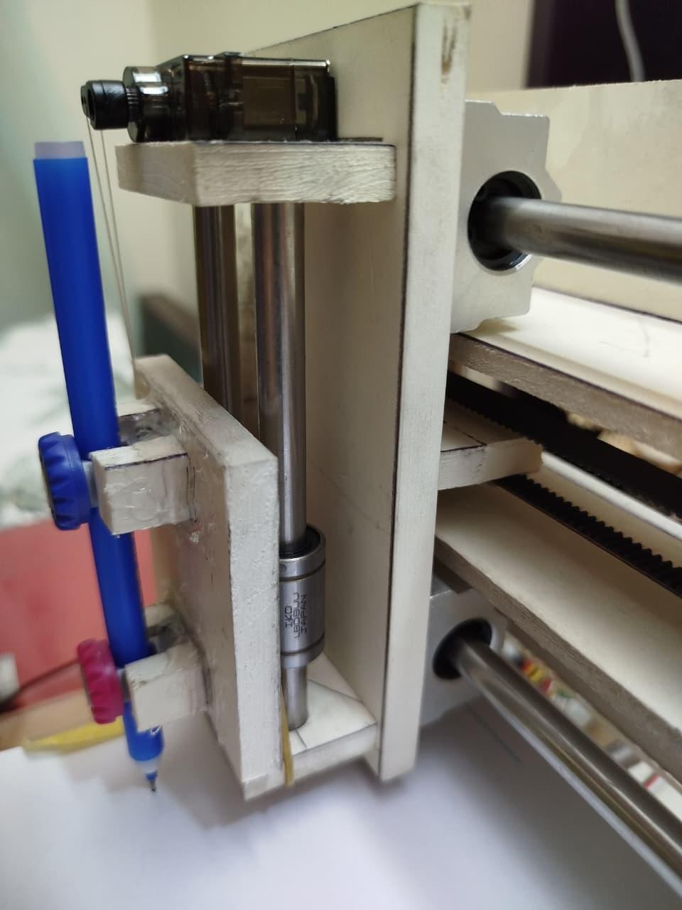

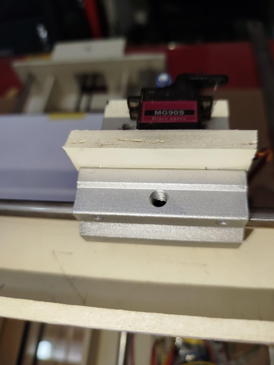

Step 4: Making Print Head/ Z Axis
I have harvested pen holder from plastic compass. Use a rubber band to create some pressure (make sure the elasticity is within the servo load capability) so the pen always stick to the paper. I have used dental floss with the servo as string to lift the pen.
The width of the print head is 6 cm. The linear rod I am using is not 100% parallel. So I used long bearings to minimize the bearing play.
Note: The size of the print head effects the print area significantly so try to make it as small as possible. Alternatively you can make x and y axis longer to increase print / plot area.

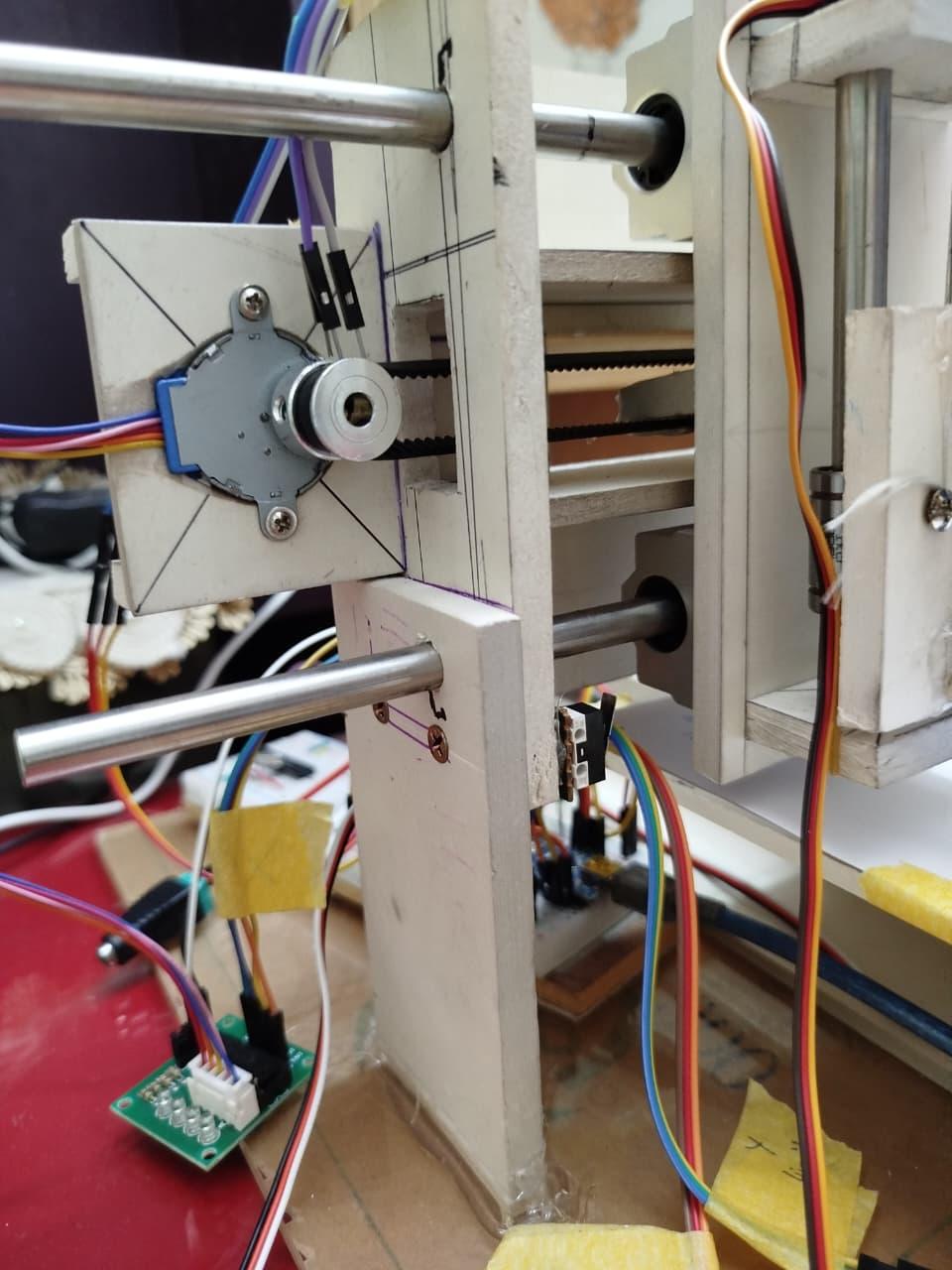

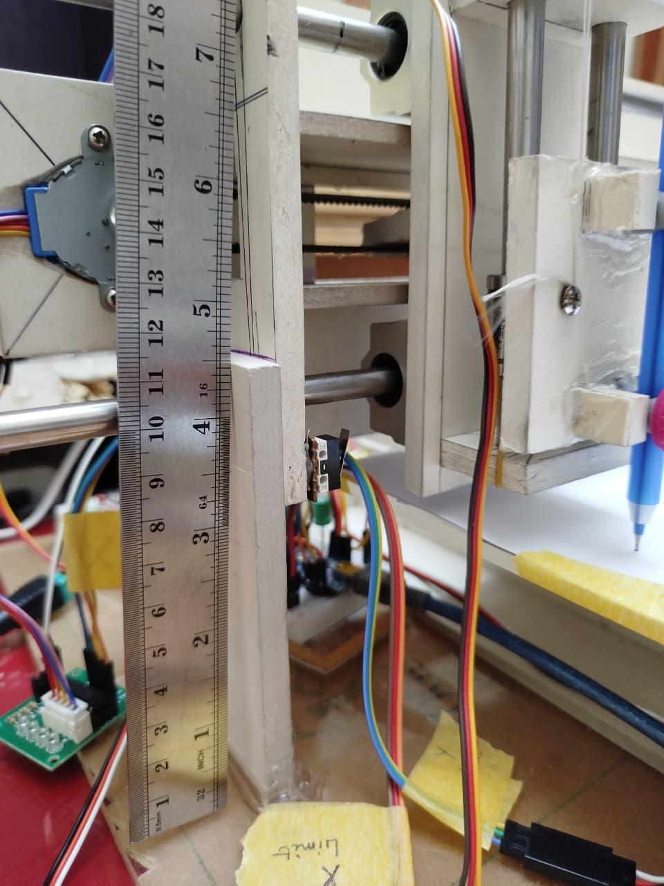

Step 5: Final Assembly
First we need to raise the X axis. Insert a pen into the print head and measure how much height is suitable. Too much height might decrease stability of the x axis. For my design 3 inch from the ground is good enough.
Now place the x axis over the Y axis like so you can get the maximum print area. Mark the position on a solid surface. I used 6mm acrylic sheet as a base and used double sided tape and glue stick to hold the position.
