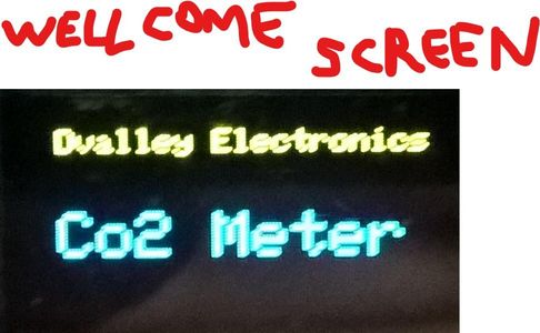

Step 3: Oled Display
The Unit without the Analog Display ( Step number 1 ) , had all information on this screen :
  1. Actual Value measured (CO2 ) is show in ppm .
  2. The Two last measures Showed within pre-set at your choice : 90 secs, 3 Mts , 6 mts , 15 mts , 30 mits , 1 hr , 3 hrs , 6 hrs , 12 hrs, 24 hrs , 48 hrs and 3 days .
  3. Show if the auto-zero is on / off ( Auto zero is the Mode ABC built in the Software ..acc Datasheet ) or Manual mode setting by Grounding Digital pin of the Arduino ( D2 ) and HD of the Sensor HD-Z19B ...for (7 seconds ) soon after Wake Up time of the Unit . The mode is show at top right up corner of the Display .
  4. The Warm-up Time of the Sensor at 500 ppm , for 60 secs ...acc Datasheet.
  5. Every measures are show at T - 90 Secs - acc Datasheet .
  6. The Unit " Learn " the environment conditions at the time, so is a must to sometimes calibrate at clean air for at least 20 minutes at Auto-zero On setting.
  7. A Wellcome Screen .

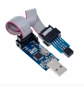

Step 5: "Burning " the CHIP With AvrDudess"
The Compilation could be a little trouble for Newbees sometimes ... i felt this in the beggin ...and thats not a trouble for every one after some practice...none the less this fact and thinking about this fase which quickly pass ....sometimes yes ....sometimes no ... pass quickly.....Thats the code ( READY ) to " Burn" the Chip ( Arduino ). :
" Burn " = ( record into the Chip ...without Compilation ) mainly for Newbees into Programming World ....
The Summit you you need :
The Code ( .hex ) + UsbASAP ( A Cheap Hardware to Programmer any ATmel Chips Directly ...without compilation...) + AVRDUDESS (A Software which "Burns" any Atmel Chip )
The use of AVRDUDESS ( 2.14 ) is an easy way to replicate the first Projects. and after some time, even if the Compilation is within Domain of any " Maker"... this tool can be util in many ways ...
Attention : The AVRDUDESS can be used direct in the Arduino IDE , with only few steps in the Panel of The AVRDUDESS and " Burn' the .hex code ...without Compilation any way !!!
