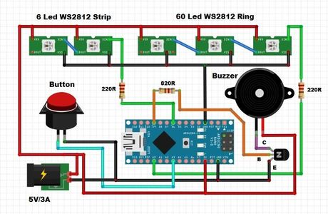

This is a very simple project and consists only a few components:
  - Arduino nano microcontroller
  - WS2812 Led ring with 60 RGB leds
  - WS2812 Led strip with 6 RGB Leds
  - One transistor
  - Buzzer
  - And big DIY Arcade button

 The game would need to be powered by a Power supply of 5V/3A or more.

Step 3: Schematic Diagram and Arduino Code
