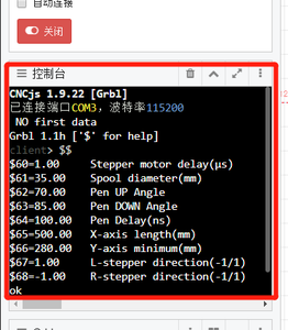

4.After uploading the program to Arduino, install the CNCjs application on the computer side, select Grbl, the port number will be displayed automatically after searching, select 115200 for baud rate, open it and establish the connection.
5.After a normal connection, the console will show the following content. And there is an OK prompt.
You can test it by typing a simple GCode after the prompt.
G01 x0y0z0 // Drop pen
G01 Z1 //Lift pen
If the test is OK, you can open the GCode file and start your drawing!
