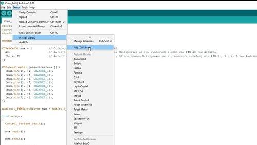

Step 13: Upload the Code
I used Arduino IDE to write and upload the code to the Arduino pro micro.
To upload the code to Arduino we need to download the Arduino IDE
After you install the Arduino IDE, download and open the Crius_HERMES_MIDI_Mixer_v10.ino file so we can Upload the code to the Arduino
I used the "Control Surface" Library for the code.
You must manually download and install the Control Surface library to the Arduino IDE.
(A BIG THANKS to "Pieter P" the creator of the Control Surface library for his GREAT work!)
To install the Library to the Arduino IDE go to the menu Sketch -> Include Library -> Add .Zip Library and select the zip file downloaded from the Github.
Then we have to select Board from the menu Tools -> Board -> Arduino Leonardo
And the Port from the menu Tools -> Port -> the port we have connected the Arduino
Now we can click Uploadand upload the code.
