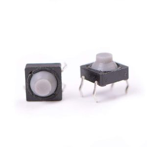

  • Silicone Switchs
I Order the silicon switchs here! You can order the exact amount or 1000 pieces for 0.03cents. you'll need 25 Silicon Switchs.

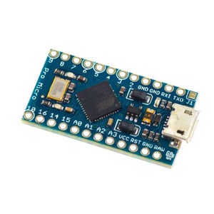

  • Arduino Pro Micro
It is important to use an Arduino Pro Micro because it uses the Atmega32U4. With this microcontroller you can connect any device and it will be detected automatically.

Step 3: Arduino Pro Micro Code
Download the Arduino IDE if you are not download Yet (why you don't have it already?) , NOW upload the code MultiKey_funciona_23_1_2022.ino code to the arduino pro micro.
After you upload the code you will notice your pc is detecting a new device it is your new Midi Controller!
