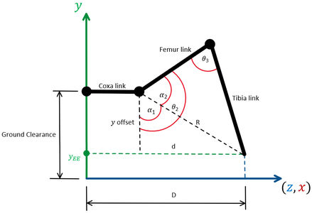

Now, lets model a leg tip of quadruped robot inside 3-dimensional cartesian coordinate, zero position for x and z axis is the coxa joint, zero position for y axis is the ground/surface. From the picture we want the leg tip is stride at a line along z axis with x position offset from its zero point, for the y axis of course when pushing/propelled robot body y axis position is 0, which mean stick to the ground. The inverse kinematics solution is easier if we split 3-dimensional point of view to 2-dimensional. First point of view is like we look at the robot legs from above, which represent x and z axis. In this viewpoint in order the leg tip reach, or move along designated coordinate it require coxa joint to rotate at certain value symbolized as (Theta 1), not only coxa joint rotation the legs also need to span in order its tip reach and move at designated coordinate, the value of leg span length symbolized as (D). Formula/equation to calculate Theta 1 and D is shown on the picture.
The second 2D viewpoint is to solve 2 other joint angle. This is where leg span length (D) data is needed, the simplest word to explain is like how much angle femur joint (Theta 2) and Tibia joint (Theta 3) needed to rotate in order to make the leg span as far as the length (D) which is calculated before. The formula to solve femur joint and tibia joint angle rotation is shown in the picture.
Now, by implementing these mathematics equation in the programming, define any where position of leg tip then the 3 joint is automatically calculated.
