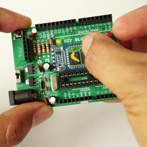

Hi everyone, now I will show you how I made arduino uno board using the atmega328p can be upload code via bluetooth HC-05 called as "DIY Bluino One". A year ago I have made a series of tutorials about how to configure bluettoh HC05 for upload code via bluetooth. This is kind of a updated version of that.
So in this tutorial we will be looking into the schematic of DIY Arduino Uno Bluetooth, modify it a little to our needs, make a PCB out of it and solder the required components to make the final product. But before starting let me tell you that I will only using 2 SMD components (AMS117 3V3/5V) to make my version of arduino because not everybody has a hard to soldering a lot of SND components. Moreover through hole components are cheaper than SMD components in most of the cases.

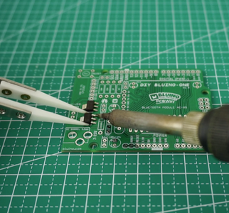

Step 4: Solder SMD Component (AMS1117 3V3 & 5V)
This project has two SMD component, it is not too difficult to solder because the size of the SMD component is quite large, so don't worry. You will need tweezers as a tool to hold the components when soldered.

Step 11: DONE: Upload Code Use Android or PC Over Bluetooth
Done! You are finish made a hardware development board "DIY Bluino One" (Arduino Uno Bluetooth). Now, time to try upload first sketch to hardware, the way to upload sketch you can use software Arduino IDE on computer, upload via Bluetooth or USB. The other way you can upload sketch use Android smartphone via Bluetooth or USB OTG. Get Android app from Google Playstore Bluino Loader, this app is for working with the Arduino Uno (DIY Bluino One), you can write, edit and upload sketches to DIY Bluino One over Bluetooth HC-05/USB OTG.
