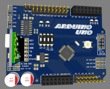

Step 3: Schematics Design and PCB:
I used EasyEDA to design the schematics of this board, there are many more features are added which are listed below in working section. If you want to modify the layout with the availability of components in your area then you can use EasyEDA and take reference as my design. The connections are okay and tested with proper net markings.
As for the PCB, I turned my schematics into PCB fabrication file. Then do some designing and place all the components at their place. Then I do manual routing of this board and download the project in the form of Gerber file.
You can upload this file to the PCB manufacturer to make a physical prototype. As for now you can get the required Gerber, BOM and CPL files only by messaging me on Instagram: Sagar_Saini_7294.

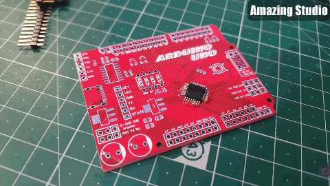

Step 4: PCB Specs and Components Mounting:
The assembly of component value is given in the picture, you can add resistor and capacitors according to that. Get me on Instagram to get the full schematics and all files. Here all the smd components like resistor, capacitors and LEDs are 0603 package. So, try to manage the same size as preferred or you can assembly service from JLCPCB that offer SMD assembly just in $8.

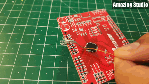

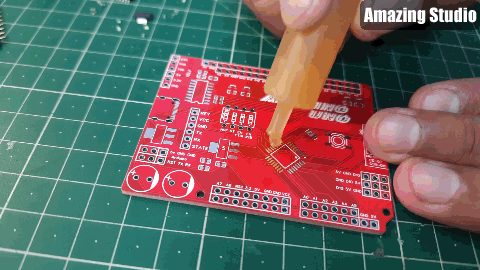

Step 5: Assembling the PCB Board:
It is very difficult to solder the SMD package of Arduino chip using simple solder, until you don’t know right method to solder.
Just solder one pin first and the add access solder paste get some solder wire on heated solder and make a layer through out the chip. Any short in the chip pins can be removed using solder wick.
It is always recommended to use excess solder paste with SMD, but clean the residue immediately after soldering.

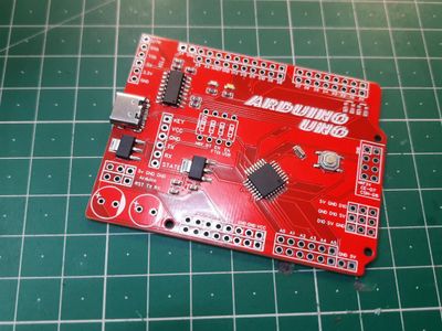

Step 6: First Power ON:
Check the power connection in continuity, if everything is okay then connect the USB power. If there is a beep then check the soldering connections. If there is any misconnection then resolder the component again. Most of the times there is short in USB type C connector or in SMD chip.

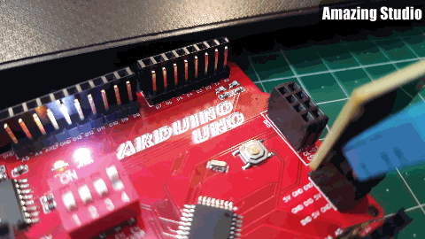

Step 12: 4) 3X3 I/O Header:
These are headers which is used to connect any digital sensor with 3 pins. Like DHT, microphone. No need to worry about the pin arrangement now. Because 3x3 headers form a total of 36 different probabilities to plug a module.
