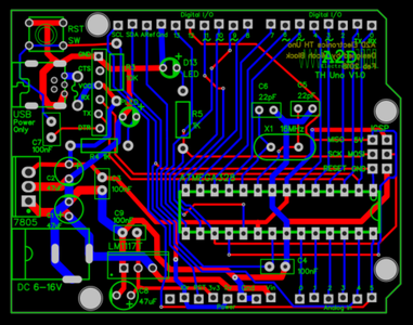

Step 5: Designing the PCB With EasyEDA
Once I confirmed that everything was working, I started making it in to a PCB using EasyEDA. I arranged all the components on the board, using the Arduino shield template on EasyEDA as the board outline. Once arranged, I used the autorouter to make all the traces. After looking over the board, I could see a few issues that I fixed manually, and then ordered my first batch of 10 PCBs through JLCPCB (amazing prices by the way).
Step 6: PTC Fuse and USB Port
After assembling the first prototype board and using it for a while, I found it really annoying that there was not a USB port onboard, so it was harder to power. Back EasyEDA again to add a though-hole mini USB port, and accompanying PTC fuse to the circuit, which will protect against drawing too much current from USB ports.
