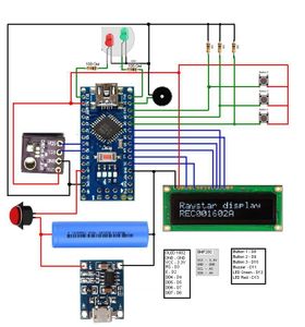

Step 2: Connection Diagram / Схема Подключения

Firstly I wanted to make a simple small beeper with a screen to show the vario and altitude values. But then I wanted more and more. As a result the device has a big bulky case with several buttons, but it can do much more useful things than I originally planned! Here are some pictures of the development process.
To reduce the firmware development time, the algorithm of the variometer averager was borrowed from these two awesome projects:
https://www.instructables.com/id/GoFly-paraglidingh...
http://redhats.ru/variometer-arduino-2015/
A lot of thanks to their authors!
P.S. I have to honestly admit, this is my first serious project on Arduino and this is my first code for seven years after graduation from University. Therefore, the code itself is creepy enough, complicated, poorly optimized and all stands on crutches! But it works! And, as is known, if something works - do not touch it! And, in general, this is not a bug, it's a feature! =)
