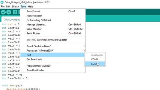

Step 8: Upload the Code
- To upload the code to the Arduino, you should download the Arduino IDE from the Arduino site: https://www.arduino.cc/en/software
- After installing the Arduino IDE, open the CRIUS_Resistor_Tester.ino file but BEFORE pressing Upload to pass the code to the Arduino
- We should install 2 Libraries :
- The Adafruit GFX
- and the Adafruit SSD1306
from the menu Tools -> Manage Libraries… -> and typing for each one its name in the search bar that will appear in the window by pressing Install
- Then we have to select Board from the menu Tools -> Board -> Arduino Nano
- And the Port from the menu Tools -> Port -> the port we have connected the Arduino
- Now we can press Upload and upload the code.
