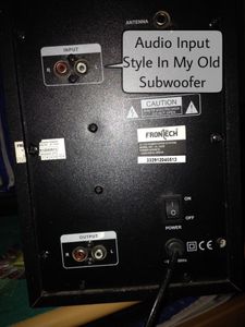

Introduction: DIY Audio Signal Patch Cable for Two Amplifiers
Welcome back guys! You remember i said you that i'm going to make an another instructable for making a patch cable which will connect two identical subwoofers or amplifiers to one audio source?? This is it!! This instructables is useful for DJ enthusiasts also as they'll get to know how their patch cables are manufactured and how they can make one for themselves. Their are several types of patch cables and this is just one of them!

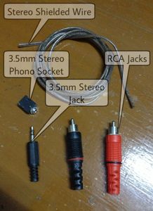

Materials needed:-

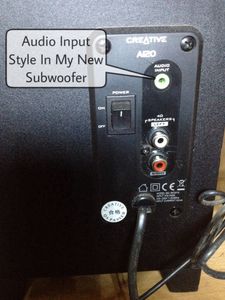

1. 3.5mm Stereo socket.
2. 3.5mm Stereo Phono Jack.

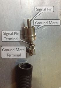

3. Two RCA Jacks.
4. 1 or 2 mts. Stereo shielded wire.
5. Adhesive(Strong enough to seal).

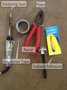

Tools needed:- Insulating tape, Pliers with inbuilt stripper or separate stripper, Razor, Soldering iron, etc..

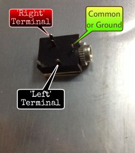

Step 3: Preparing 3.5mm Socket
Always remember that Red wire is for right channel and Black wire is for left channel. For your convenience i've labelled the 3.5mm socket in the image. Take a desired length of shielded wire and following the 'Step 2' method, solder it on the socket terminals. Then take a piece of steel wire and wrap it around the socket to make a nice firm grip of wire. Lastly, cover the whole socket using insulating tape and put some adhesive to seal it.

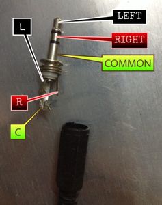

Step 4: Preparing 3.5mm Jack
The jack is clearly labelled and all you have to do is to follow the very 1st step and soldering it correctly on correct pins. The red wire goes to the right channel, black goes on left and the shield wire is soldered on the ground metal pin of the jack. After finishing don't forget to grab the wire in the jaws of ground metal pin of the jack, as it will make a sturdy grip!

RCA Jacks can be easily prepared as it has only two terminals. After following the 'Step 1', ground wires being common to both Jacks, connect and solder the red wire to the signal pin terminal of the Red Jack and do the same for black. Follow the last diagram that shows wiring of RCA Jacks. Then grab the wire firmly to the metal case jaws.
