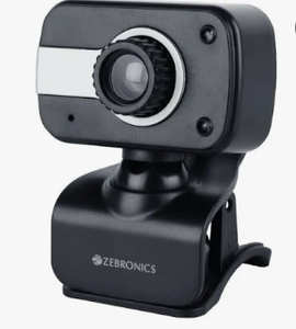

A computer with a webcam (or a video file for testing)

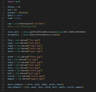

import cv2
import cv2.aruco as aruco
import numpy as np
import math
Offset = 50
pid = 99
pcenter = (99,0,0)
gdist = False
comb = False
# Use a demo video OR the webcam (uncomment one)
cap = cv2.VideoCapture('vid.mp4')
# cap = cv2.VideoCapture(0)
aruco_dict = aruco.getPredefinedDictionary(aruco.DICT_ARUCO_ORIGINAL)
parameters = aruco.DetectorParameters_create()
fire = cv2.imread("fire.jpg")
wind = cv2.imread("wind.jpg")
light = cv2.imread("light.jpg") # lightning
earth = cv2.imread("earth.jpg")
water = cv2.imread("water.jpg")
blank = cv2.imread("blank.jpg")
ice = cv2.imread("ice.jpg")
explo = cv2.imread("explo.jpg")
wood = cv2.imread("wood.jpg")
lava = cv2.imread("lava.jpg")
storm = cv2.imread("storm.jpg")
boil = cv2.imread("boil.jpg")
scorch = cv2.imread("scorch.jpg")
magnet = cv2.imread("magnet.jpg")
basic_elements = [fire, wind, light, earth, water]
new_elements = [ice, wood, lava, storm, boil, explo, scorch, magnet]
