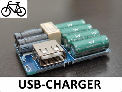

Hi,
in this Instructable, I want to show you how to build a powerful and intelligent USB-Charger for your bicycle hub dynamo. With this charger you can simplify long distance traveling with your bicycle, because you are not depending on external power solutions like solar chargers or AC-Adapters. You can run your navigation on your smartphone at full brightness while traveling and your battery will always stay at 100%.
But first the story about the charger:
My journey with USB-Chargers started in 2017, where I have published my first charger design here on Instructables. With the design from 2017 the so called " 10€ BICYCLE USB CHARGER ", I have started a lot of tours and it worked okay... But not perfectly, the amount of power was not enough for me. I wanted to get more power out of my dynamo and wanted to build this charger more stable and safe.
Also the charger from 2017 had an over-voltage protection, where the over voltage was burnt in heat, and after the charger is getting over 45°C, it will shut down. This feature was necessary in the design, but for me it was always something I had to optimize...
So I started to design a new charger. The Version V3.1 the so called "Fahrradlader V3.1"(German for Bicycle-Charger V3.1)
The specs of the "Fahrradlader V3.1" are:
- Input-Voltage from USB-Hub-Dynamo: 6-100V AC
- Dimensions: 42x33x14mm (LxWxH)
- Supercapacitors: The charger can charge your phone up to 20sec, after you stopped riding
- Capacitive Compensation: For more power at low speeds
- Output Power: 1 Ampere / 5 Volt at 18-20km/h (depends on your Hub-Dynamo)
- Charge-Optimizer: Charge your phone always with the maximum of the aviable power
- No heat due Overvoltage. The charger stays cool and can even charge at 100km/h
- Cost:+-20€ (Material)
I decided to make the charger Opensource, so you can build the charger
by yourself. If you don't have the opportunities to build the charger at home, because you have no soldering tools for SMDs, you can also find pre-assembled and tested chargers on my new Website, there you will also find some more information: Fahrradlader.de (German only)

Step 1: Functionality
The bicycle charger V3.1 is built on the basis of four 3F supercapacitors. These are first connected to the dynamo with a relay. When you start your ride, the supercapacitors are charged by the dynamo. If the voltage at the supercapacitors reaches a value of ~5V, the bicycle charger is active and passes on its 5V voltage to the USB port. In addition, the relay is opened at this point and the charging is now continued via a 150V power MOSFET. This is done because the installed relay only has a lifetime of about 100 million switching operations. The installed MOSFET, on the other hand, has far more switching operations and also switches electrically and not mechanically.
After the relay is switched off and the MOSFET is switched on, the super capacitors continue to charge up to a voltage of 10V. Once this voltage is reached, the MOSFET opens and disconnects the bike charger from the dynamo. Now the advantage of the supercapacitors comes into play. Due to the extremely high capacity, the charging process can now be completely pre-set from the supercapacitors. In the process, the voltage at the supercapacitor slowly drops. When the volatage reaches a value of ~8V, the MOSFET closes again and the capacitors charge back up to their 10V.
The advantage here is that the charger is completely disconnected from the dynamo. No overvoltage etc. is dissipated in heat. Also an interruption of the charging process at very high speeds is thereby excluded!
Another advantage of this is that the charging process can be continued even at a standstill. Thus, the charging process can be continued for several seconds depending on the charging current.
Until the charging process begins, it takes about 10-15sec from the start of driving.
