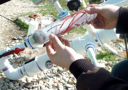

Step 1: Parts and Supplies
Parts for bait launcher are listed in the photo provided - except:
2 - 3/4" to 1 1/4" 45º PVC Elbows (depends on the leg size you use)
2 - 1 1/4" to 3/4" PVC Reducers (if you use 3/4" PVC for legs. The average 3" Tee will have 1 1/4" sides)
4 - 2" to 1" Threaded PVC Reducers
3 - 1" Dia PVC Sch 80 Nipples
1 - 2" PVC Coupling
1 - 3" PVC Coupling (if you cant get a 3" to 2" PVC Reducer)
4 to 6 - 2" PVC Caps (for frozen bait tubes)
1 - 6' piece of 2" PVC (for bait tubes)
4 to 6 - water bottle tops (as seen in video)

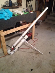

Air Compressor I use in this build:
To launch the bait launcher you need an air compressor.
Air compressor can be a small vehicle tire air compressor that has a 250 psi rating. Purchased mine from Harbor Freight Tools for around $10, or a large air compressor.
Tools:
Screwdrivers Philips head, Flat head (might not need, but good to have on hand)
PVC Cutter or Hacksaw
Sandpaper (to smooth out cuts on PVC)
Pipe wrench or Channel Locks
Drill
**1/4" Drill bit (hole in 3" PVC Cap for pressure gauge)
**you might have to measure your gauges post to mount on PVC for right drill bit size. A 1/8" NPT Back, or 1/4" NPT Back are the standard connection sizes I found.
1/4" to 5/16" Drill bit (to drill a hole in the ball valve handle for leverage) - Optional
Supplies:
PVC Primer
PVC Medium-bodied Cement
Teflon Tape
Some type of pull handle for leverage on ball valve (leave that up to you)
