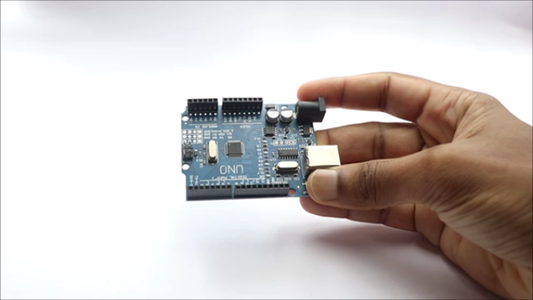

Arduino Uno

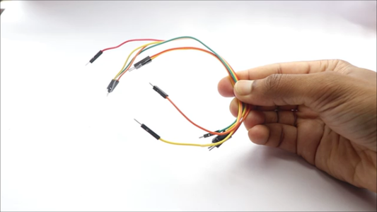

Jumper wires

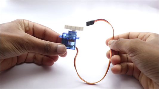

Micro servo plastic geared

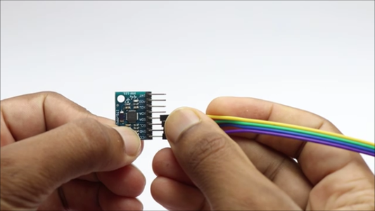

The circuit is really easy for this project since we have only 2 parts here
Micro servo and MPU 6050 let me explain the connections one after the other

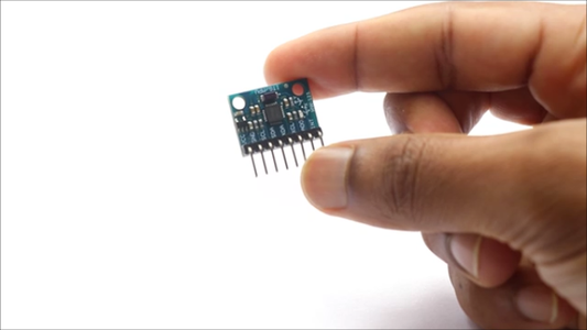

MPU6050
The MPU6050 sensor is connected to the Arduino using I2C communication
VCC of the sensor to 5V or 3.3V on the Arduino
GND to GND on the Arduino
SCL to A5 on the Arduino and SDA to A4 on the Arduino

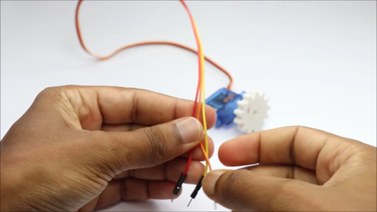

Servo Motor
Signal pin to digital pin 2
VCC to 5V on the Arduino whereas GND to GND on the Arduino
I have made the connections using jumper cables, you can also simplify using PCB

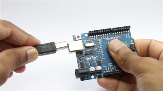

After you have built the circuit you can simply connect the uno board to computer using programming cable and open IDE
Paste the code and click on upload without any hassle the code should be uploaded and now we can proceed to test the circuit.

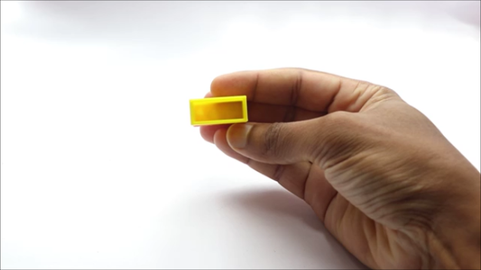

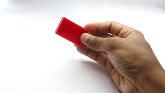

I have made a small case for this sensor and you can use other options too.
Place all the components on a piece of board and glue it with adhesives and hot glue if necessary, You might be thinking of that white gear attached to the horn of the servo, that is just an optional part, you can simply glue the stick to the servo.

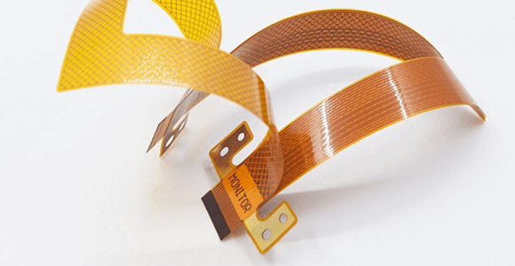

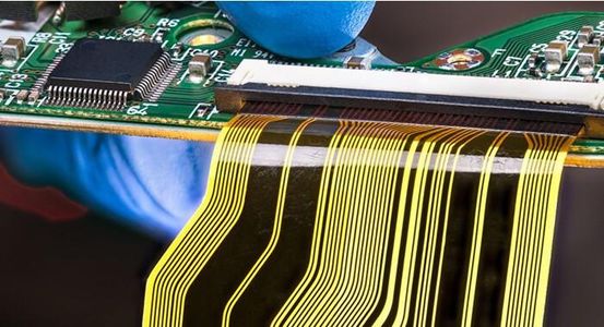

You also can simplify this circuit with a Simple small PCBComplete your electronic projects in the best way from PCBWay
They are raining great offers since their 10th anniversary is live enter now
Why them? They have provided me with the best PCB and The quality is just amazing compared to other providers in the market, They also have Color PCB printing Try it out.
Don't have a 3d printer? You can get the best 3d printing service here

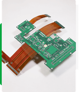

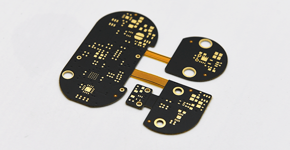

Check Here for Rigid-flex Pcbs with this your circuit becomes flexible! I have added the images to this step kindly check.
A revolutionary solution that combines the best of both rigid and flexible circuitry to elevate your electronic projects to new heights.
With their expertise in advanced manufacturing techniques, they offer a seamless integration of rigid and flexible components, ensuring enhanced reliability, durability, and space-saving benefits.
