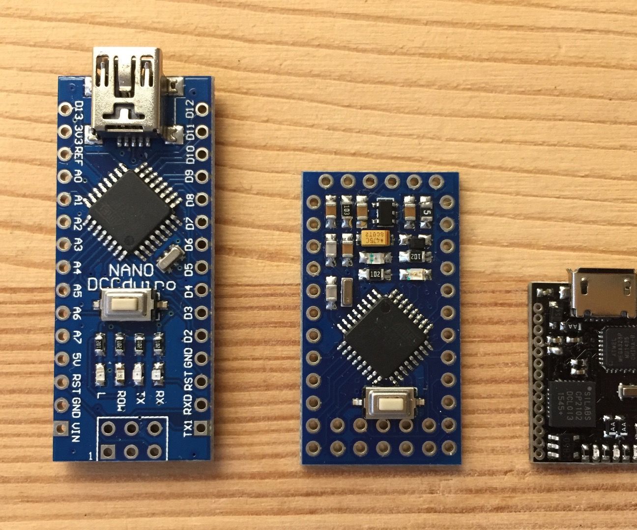

A prototype board was made as proof of concept, the components, placements, and connections are:
  • ATmega2560 chip from an Arduino Mega2560 clone (functional chip and bootloader) removed with a hot-air gun, soldered on to a TQFP100 breakout PCB.
  • Connect all VCC/AVCC (chip pins 10, 31, 61, 80, 100) together and GND (chip pins 11, 32, 62, 81, 99) together.
  • 0.1uF bypass capacitor x 3, connected in parallel to 3 of the VCC/AVCC and GND pairs (chip pins {31,32}, {61,62}, {99,100}).
  • 10k pull-up resistor x 1 connected between RESET (chip pin 30) and VCC/AVCC.
  • LED x 1 and 1k current limiting resistor x 1 connected between D/13 (chip pin 26) and GND, this is same as the Arduino Mega "L" LED, to be us as indicator to test prototype.
  • 16MHz ceramic resonator connected between chip pins 33 and 34, with resonator's ground pin connected to chip's GND.
  • CP2102 USB to UART TTL Module (one that has a DTR pin), with the connections:
    • 0.1uF capacitor x 1 between module's DTR pin and RESET (chip pin 30).
    • Module's RX to D1/TX (chip pin 3).
    • Module's TX to D0/RX (chip pin 2).
    • Module's 5V to chip's VCC/AVCC.
    • Module's GND to chip's GND.
After the driver for CP2102 was installed, a few sample Arduino sketches such as "Blink" and "Fade" were uploaded to make sure the chip was still functioning before designing the board in Eagle PCB.

Specifications/features of the board layout:
  • Total component count on board is 12.
  • Board dimension is 38.1mm x 38.1mm.
  • Connector pins to match CP2102 module.
  • All digital pins and analog pins arranged in sequential order.
  • Mounting holes.
  • 4-layer PCB (failed attempt to route the traces in 2-layer).
