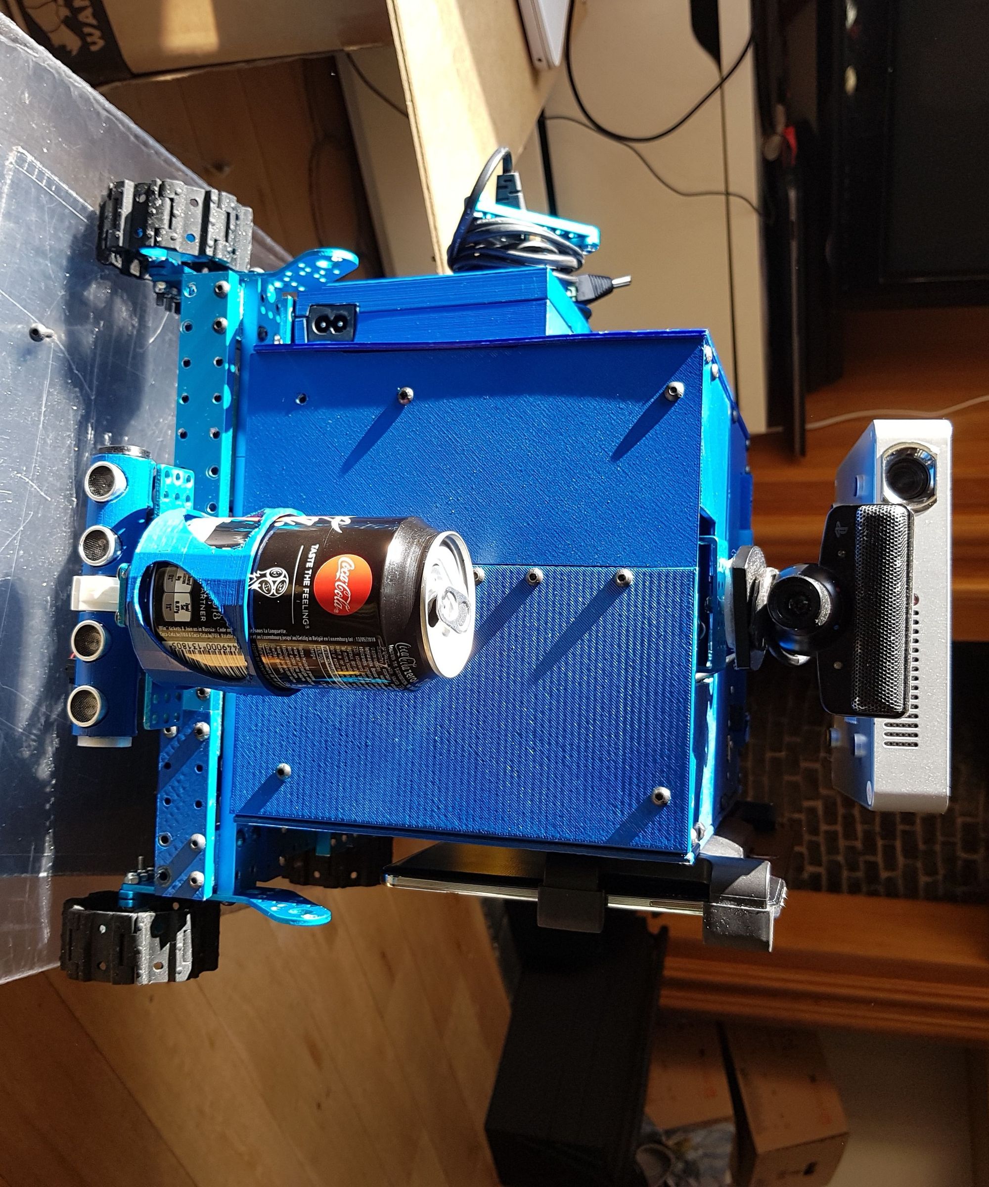

So in this instructable I will show you how I make my battery for my robot. I need power for my arduino board(me auriga makeblock board based on ATmega2560) , and my raspberry pi ( with ps eye; hard drive 2g ...)
So I need:
_output 7.4v for the arduino board; 5v3A for the raspberry pi
_input 5v for charging the battery
_ switch and led for the 2 board
extra
recharge the battery with a Qi charger
add a hub usb
I try to make it a max with what I have

Step 2: Building
I think the draw explain better than me
my battery is compose of 2S3C it already has a protection board so we need few soldering
battery + ----------switch1&led3--- dc barrel 2.1 -- arduino board
+ -----------switch2&led4-----lm2596---micro usb cable1------------raspberry pi
+ ----------battery charger
- ------------led3--dc barrel 2.1 arduino board
- ------------led4--- lm2596-----------micro usb cable1----raspberry pi
- ------------battery charger------micro usb cable2
take the empty box make the hole for the lcd module, the 3 different cable, 2 led ,2 switch

I use a lm2596 down to 5v I solder it on the same switch as the raspberry to power it in same time
for beats speaker :
I remove the battery and I solder an other lm2596 down to 4v they are very easy to use like all the other with a switch
for the box
I print a 3d case you can download the doc boite haut.stl and boite bas.stl
I make 1 big hole for the cable it more clean
to resume
we have 5 cable 1 for the raspberry pi 3
the arduino board
the hub usb
the beats speaker
and the last one to recharge the battery
