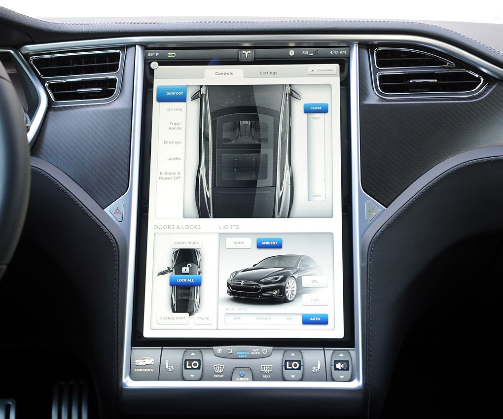

Introduction: DIY Beaglebone CAN Bus Cape
This is an addendum to my other tutorial exploring the Tesla Model S CAN bus, for that tutorial I needed some way to connect and send messages over the CAN system, but didn't want to pay and arm and a leg for a fancy Serial "Cape". So I opted to make my own using some cheap, off the self IC's and some other electronic paraphernalia. The build is pretty simple and nothing to look at, but it works well and is fairly inexpensive.
