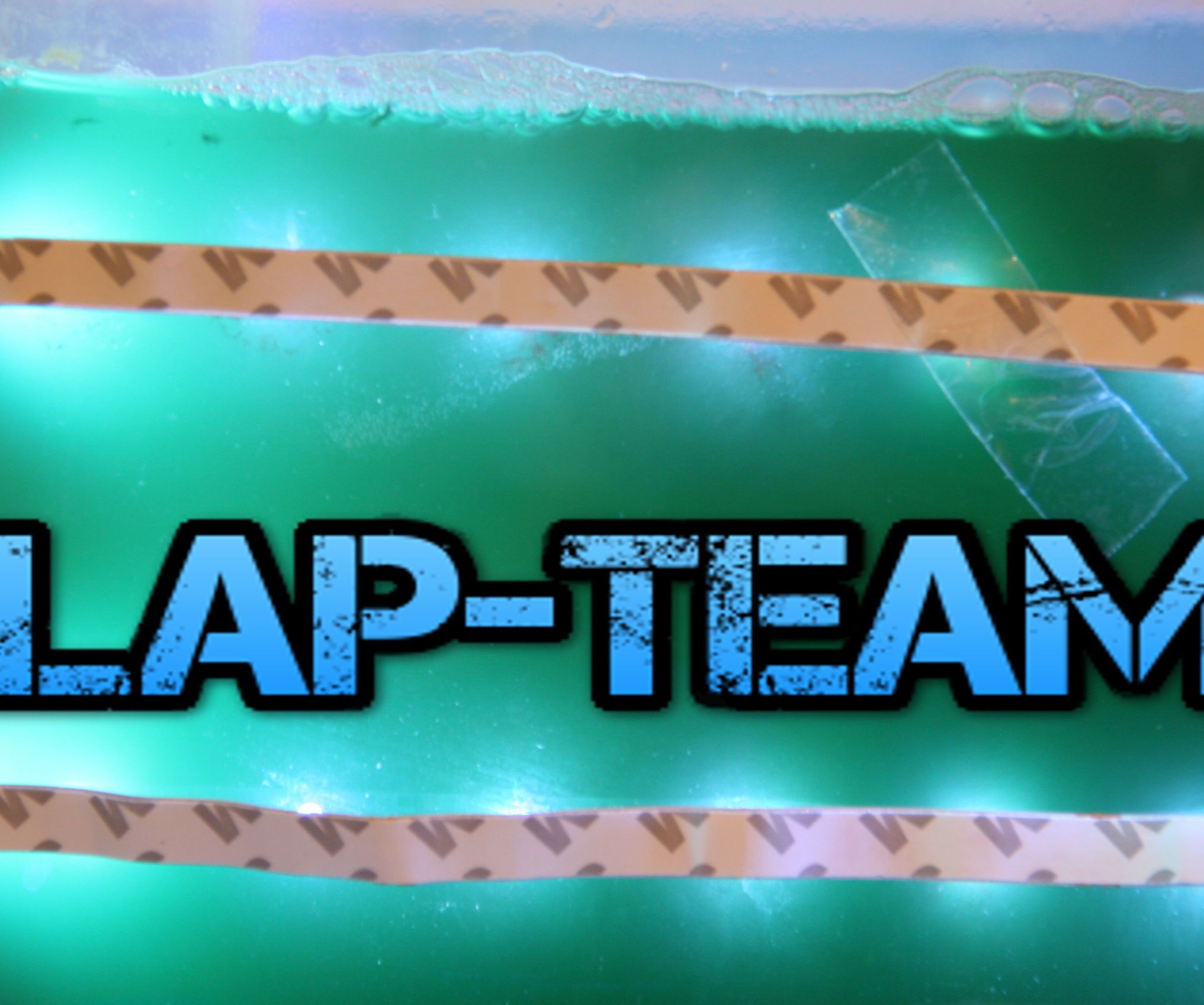

- A RGB LED Strip, you can find them for about 2$/meter or even cheaper on some websites. Look at my pics to see how it looks like.
