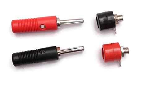

15 x Female Banana Connectors (7-0Black, 8-Red)

Few Male Banana Connectors

  • Now add all the components(Banana Connectors, Switches and the Digital Meter) to the front panel.

Step 7: Banana Connectors
  • I made few connecting wires using some banana and alligator pins.
