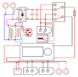

Step 3: Electrical Connections
Having prepared the space in which all the components of the power supply will be housed, it is necessary to carry out the electrical connections as in the diagram. But let's go in order ...
The alternating current of the house enters the IEC C14 plug and arrives at the primary central windings of the transformer (which in my case has two three windings).
The two windings that drive out the 12V alternating, I connected them in parallel so that the transformer can deliver double the current (which in my case is 2.4 * 2 = about 5A).
The two wires of the alternating 12V are connected to two banana connectors that supply the alternating 12V (which at the moment I don't know how to exploit but which could be used in the future ... why not have it!).
The 12V alternating current then enters a prefabricated diode bridge which rectifies the "negative" half waves of the alternating current in order to have a current that is not direct but not alternating.
To rectify the "non-direct current" it is necessary to add a capacitor (or more). For this I have added in parallel to the output of the diode bridge (by Graetz) two parallel capacitors of 2200 micro Farads.
The current of the transformer, which has now become continuous, is connected to the outputs of a bipolar switch which switches the direct current input of the power supply.
In fact, a female XT60 and a DC jack input are connected to the other two pins of the bipolar switch in order to decide, with the switch, the DC input that the buck boost converter module must receive.
Immediately before entering, with the central wires of the switch, in the buck boost converter module, it is not necessary but it is strictly advisable to add a fuse holder with a 5 amp fuse inside in order to protect the buck boost converter module like all loads. that he controls.
At the output of the cubk boost converter module then several outputs are connected in parallel such as a two screw terminal, two XT60, one female and one male and two banana connectors for positive and negative.

I made the connections after the buck boost converter module with a single wire that starts its connection path to the XT60, then to the other XT60X, then to the terminal, then to the banana and finally to the buck boost converter module. In this way I have not created a bundle of red and black wires and then splice them together in a single cable.
Subsequently I connected the transformer in parallel in such a way as to be able to have a 12V alternating but that it could supply double the current of a secondary winding only (therefore 5A in total)
Then I connected the commutator paying close attention to the colors and adding a heat shrink tubing to each weld because being full of holes, I would never want something metallic to come in and make a mess. I also added the sheaths also because everything is very tight inside and very often one component rests on the other and it is better that everything is electrically "untouchable".
I then continued to add the capacitors in parallel to the diode bridge output, the fuse, the DC inputs (i.e. the XT60 and the DC jack) and finally I connected the fan to the negative that enters the buck boost module and to the positive before the fuse (so that the fan does not add to the currents through the fuse).
