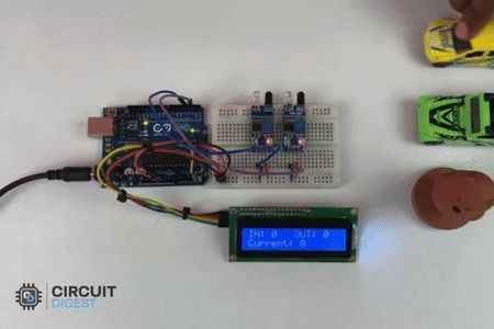

Step 2: Building the Hardware Setup
The image above shows the hardware setup of the Bidirectional Counter using Arduino and IR sensors, based on the circuit diagram.
Power Supply:
To power the entire setup, I used a 12V DC adapter connected through a barrel jack.

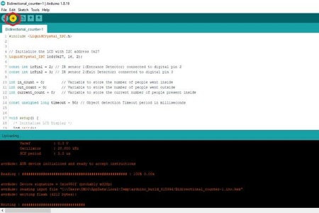

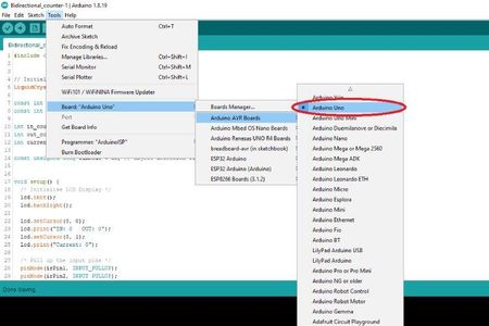

Step 5: Upload the Code to Your Arduino
To get your Bidirectional Counter working, you need to upload the code to the Arduino.
How to Do It:
  1. Open the Arduino IDE on your computer.
  2. Connect the Arduino board using a USB cable.
  3. Select the correct board and COM port in the IDE.
  4. Click the Upload button to send the code to the board.

Step 6: Test Your Build
Now comes the most exciting part, testing your project!
What to Expect:
  1. If everything is connected and coded properly, you’ll see the Bidirectional Counter in action.
  2. The display will show the current number of people or objects inside.
  3. It will also keep track of the entry and exit history, showing how many have gone in and out.
