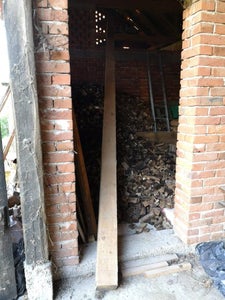

So I have an old barn at home which was mostly used as a depository for old useless stuff. So while I was thinking about how to run away from all that COVID circus that has been going on lately, an idea of making a billiard room (man cave) fell on my mind. In the end, it turned out that this was probably the best decision of the year, while this is surely the most used room in the whole village.
For this project, I used the wood (fir) that was drying for some 5 years, it's very light and easy to work with and I had it a lot laying around.

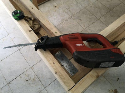

Used tools: chainsaw, jigsaw, sander, sabre saw, planer tool

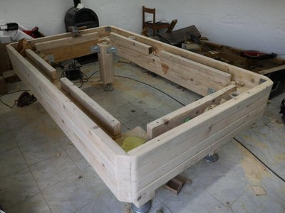

Step 3: Main Frame Design

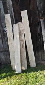

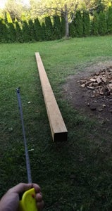

I've forgotten to take a picture of the all planks I've used in this project, but you'll get the point soon enough. Another thing to mention, I don't have the exact measures of every part because most of it was done "on the go", even if I want it to, I could not remember it.

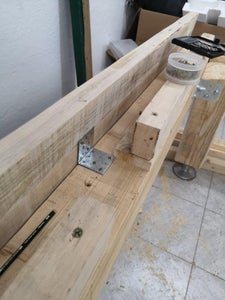

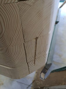

For the main frame I've used 6m long piece of wood which was around 20x25cm wide and had it cut to desired dimensions. Legs were cut out of thicker 30x30cm pillar. This is starting to be heavy..
I must add that later I've figured that those pillars could be connected with a much stronger connection, so please don't copy the way I connected them, moreover, I recommend you to look under the roof of your house for joint tips.

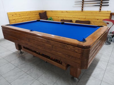

Step 11: Shall We Play?
Time has finally come. After almost a month of carving and sanding, it is possible to play a game on the table. I couldn't find free time for a whole week to varnish, because we were constantly playing.

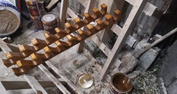

Step 13: The Cue Holder
I think that the pictures are good enough for description. This seemed like a much cheaper, nicer, and simpler cue holder than the ones I've seen on the market.
