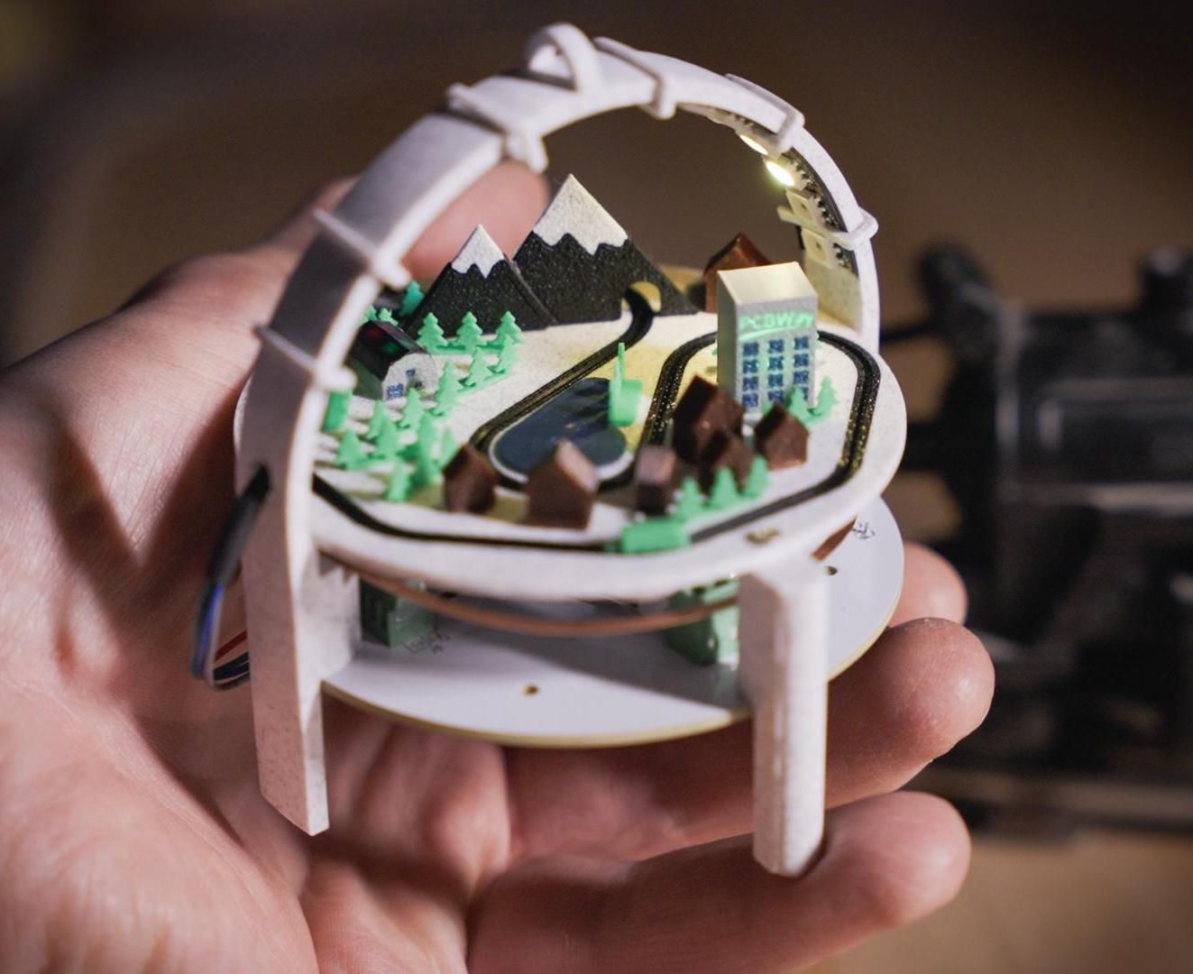

Introduction: DIY Bitcoin Lottery With Raspberry Pi
There was a time when I was really into Bitcoin mining. I had a bunch of GPUs running and it was a fun hobby that surprisingly made me a little money as well. It was a fun experiment but I eventually ran out of time to play around with it, and it was a good time to sell everything, so that is what I did. I kept a few of the small ASIC block erupters. Fast forward 3-4 years, Bitcoin is in the news again $4000 US for 1BTC. Crazy! So I made this fun little device that will never actually make money(Unless you are lucky!) It is a conversation starter.

Step 3: 3D Print the Body!
The files are up on Thingiverse here: https://www.thingiverse.com/thing:2494568
Pretty easy to print, any settings should work.
Step 4: Paint the Back White(if Its Not White)
I was using black filament, so I decided to paint the part that reflects the light, white.
Step 5: Assemble the Body With Pi.
Pi Mounts to the back. I use Torx screws, M2.26, plastic threading.
Plug in the block erupter. Hook up the fan if you are using one.
